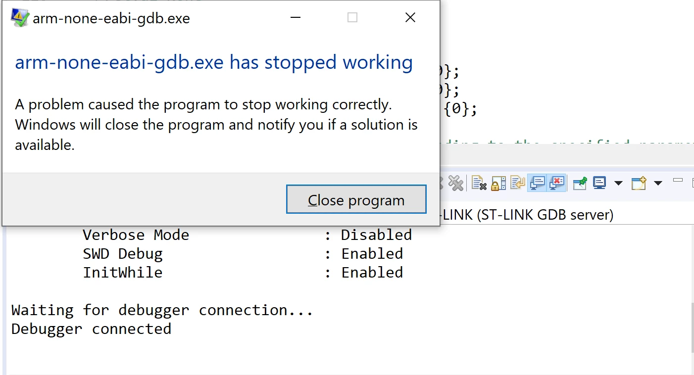

Debugging issue: "arm-none-eabi-gdb.exe has stopped working"
  • November 6, 2020
  • 8 replies
  • 5652 views
When I try to debug my code before running, I get the following error "arm-none-eabi-gdb.exe has stopped working". I am using STM32CubeIDE 1.4.0 with a Nucleo L476RG board. I have tried restarting the IDE and computer. Any advice is appreciated, thanks.

Experiencing the same issue. Any help with getting past this error?

Can you try on the new STM32CubeIde 1.5.0 ?
Thanks,
Laurent

I am using 1.5.0. Just bought a Nucleo64 board to play around with the STM32 and following Digikey's youtube intro videos. But I did fix the issue last night by playing around with the Debug Configuration settings. I set the Reset Behavior to "Software System reset" and the issue went away. Thanks for replying.

If you go into debug configuration and activate the "gdb server log" and set the settings to when it crashed. Could you send that log to me?
You can send it to me in a private message.

I tried to modify debug configuration as Markus mentioned above, then this issue doesn't appear on my L476RG.
I am using IDECube 1.6.0 / Windows 10 OS.
