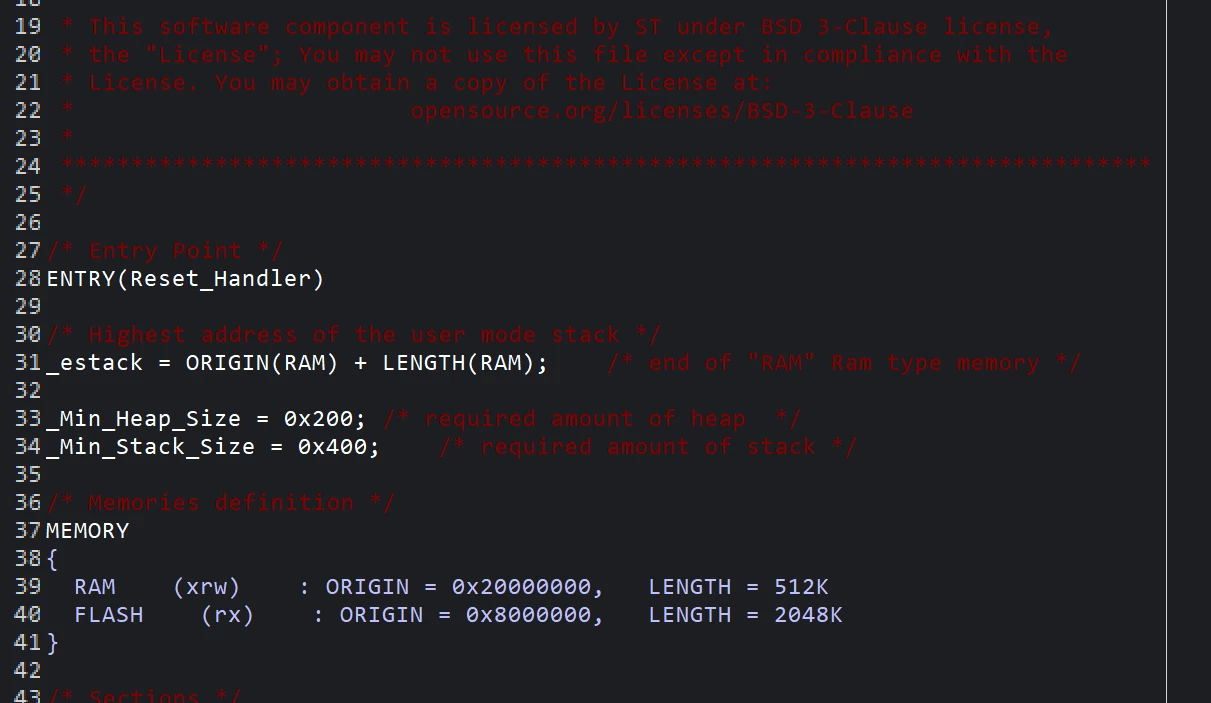

By the way, do you know how we change the colors of the files associated with the linker (* .ld). When I use a colorization in "night" mode, the flashcard files become unreadable and I didn't find where, in "preference->", we could change that ...
I use dark mode as well and the LD file is readable, but not the greatest color scheme choice. I've just learned to ignore it since I don't edit the linker file very often. Is your actually unreadable?
