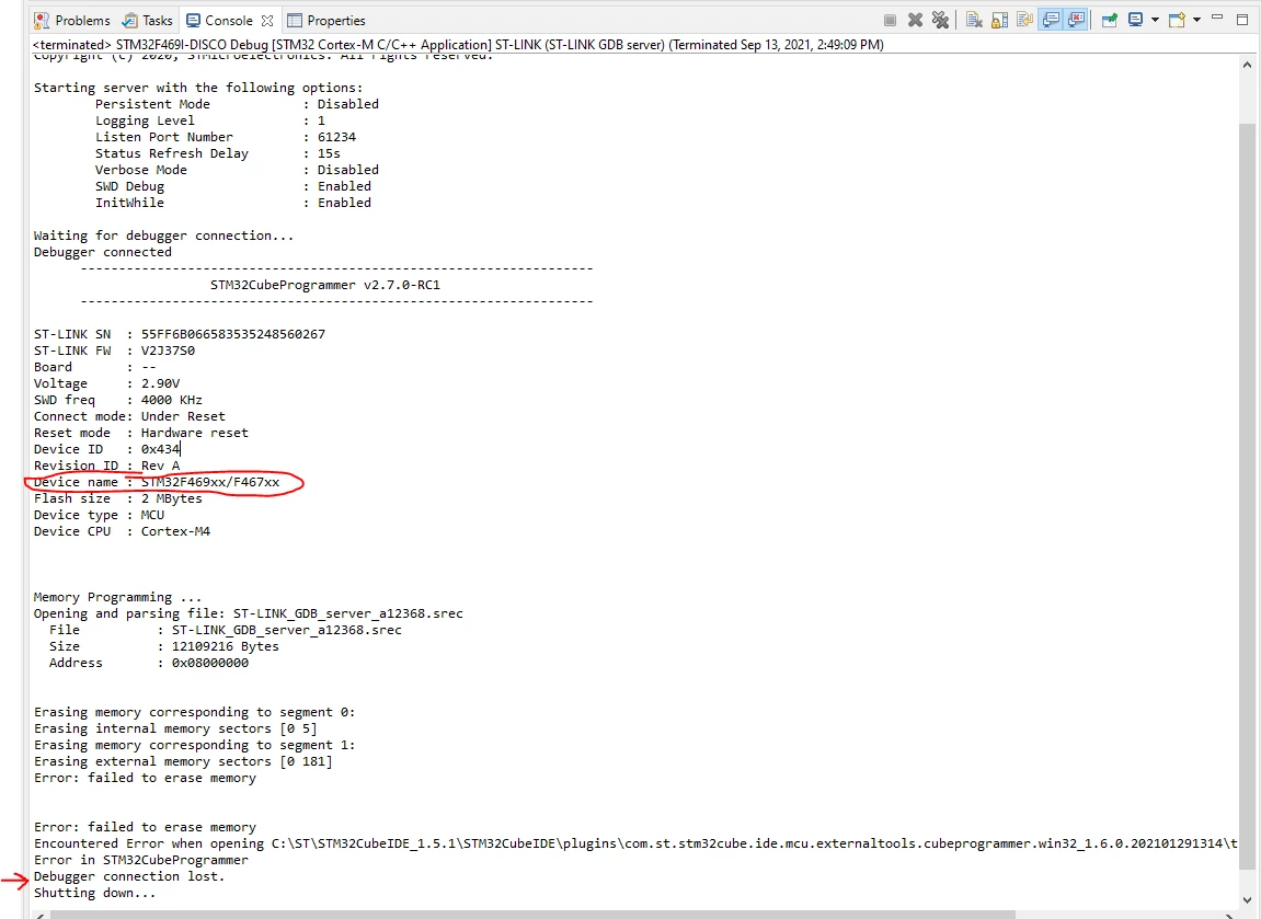

I made a software on the STM32F469-Disco and now, I would like to use the same project on the STM32F479VI with the MB1166 (touch screen).
If I create a new project, no problem, I can flash the microcontroller.
If I start from the software made on the demoboard, I can compile but I cant' debut and I'have got the information in attachment.
So I can conclude that the problem is software. I think, with the picture that is a device issue.
What is your point of view.

Hello @RFREN.1​ ,
Have you tried with different boards/MCUs ?
Try select "Erasing & Programming" on the left, then do a "Full chip erase".
If your issue is solved, please select the answe as “Best�? as this will help other users to find this response faster.

Thanks for your comments. A made a full erase and it's not working.
How Can I change MCU from an existing project ?
Thank you

Try using SWD mode instead of JTAG, and check the assignment of the SWD pins.
Maybe your code into low-power modes.
Are you using "connect under reset" or "software system reset" mode?

Hello, I success to put the program the microcontroleur. thank for your help.

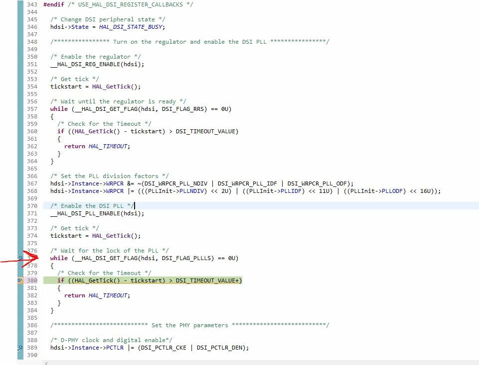

Now, I have another problem. The PLL for DSI doesn't to lock.
See the code generated automaticly by STM32CubeIDE.
No flag come to pass the "WHILE".
