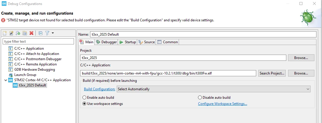

Debug CMake project with STM32CubeIDE
0693W00000D08PGQAZ.pngHey, I'm using the latest Cube IDE and would like to Debug a Cmake Project.
I'm using an Stm32F429 Disc Board for testing purposes.
The Project Structure looks like this:
  • myProjectSourceCode
    • app (contains main() + ASM Startup Code + App Code)
    • modules
      • SomeModuleCode (this code is used in multple applications)
      • STM32GeneratedCode (this code was generated using Stm32Cube IDE. It contains the ioc file + all STM32 HAL drivers)
  • SomeExternalLibaries
  • build
Simple Debugging of the generated code works nicely =>so there is no hardware issue there
I imported the whole project structure as a "makefile project". By doing so I can actually build this cmake project within STM32CubeIDE.
Now the problems arise when I try to create a debug config.
STM32CubeIDE always tells the that no target device was found.
How can I tell the debugger that the target is an STM32F429?
Could you help me out here?
thx, greets Julian

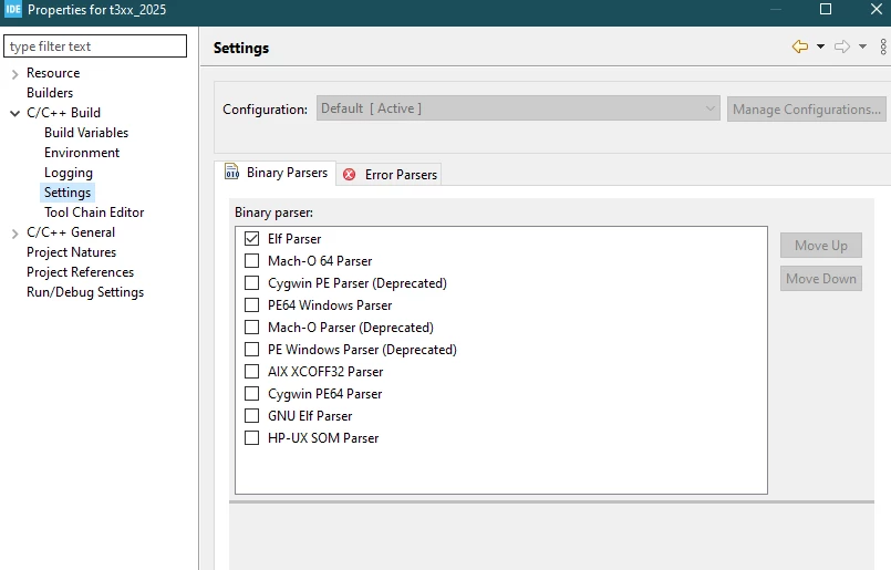

+ Either from project properties > C / C++ build > Settings > Mcu ... just set select your target device
+ Or File > Import > C/C++ > STM32 CortexM executable

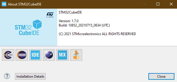

Hey I'm already running 1.7.0.

0693W00000D0EfLQAV.pngHey thx for your answers.
The tab "MCU" is not available from this CMake project (can i somehow enable it)
I'll try to test your second suggestion File > Import > C/C++ > STM32 CortexM executable and provide feedback. :)
