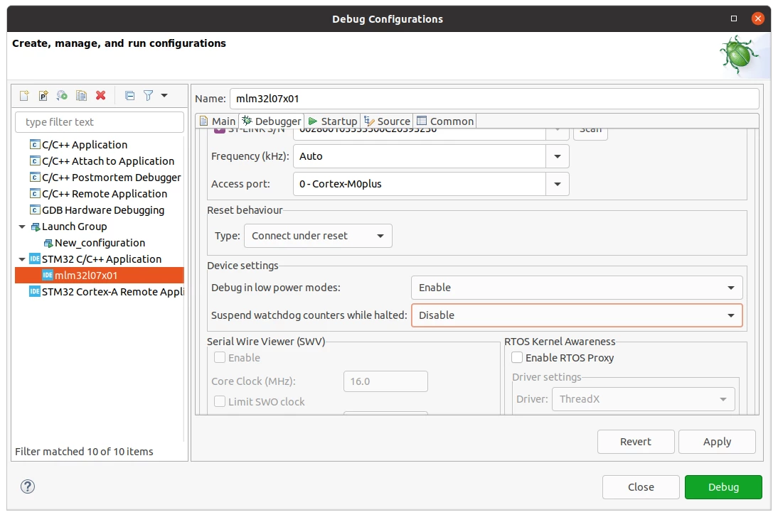

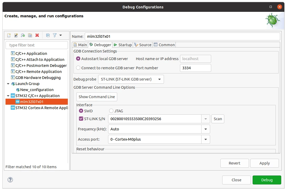

I've developed a program using the I-CUBE LRWAN package, but I'm having a problem debugging it. Here is the configuration I used for debugging:
The errors I'm encountering are as follows:

    Hello @eljohrikm,
    Check powering jumpers. Try to connect Under reset mode.
    Hope this helps.
    Imen

    eljohrikmAuthor
    July 12, 2023
    I did that, but the same problem persists.
    July 13, 2023
    Make sure to upgrade your ST-Link firmware and using latest release of tools.
    Tesla DeLorean
    Guru
    July 13, 2023
    Makes sure the code isn't purposefully disabling or reconfiguring the SWD pins.
    Disable the firmware from sleeping the MCU, and turning off power to the debug circuits.
