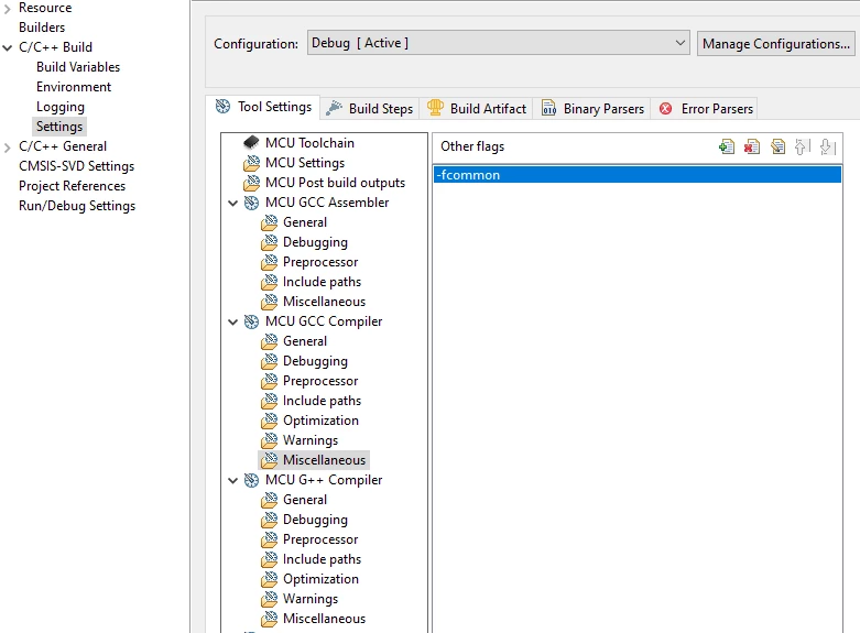

Dear friend: I've been working with the STM32CubeIDE V1.8.0 ( I've continued working with this version because I found some problems and, with your help it worked well) . I downloaded this week the v. 1.12.1 and I had a problem: In the older version,
define the global variables inside a variables.h file, and was possible to use within several procedures (*.c) only informing with #define "variables.h". In this version it isn't possible.
How can I declare the global variables ?

Use extern definitions in the include file and define them ONCE in a SINGULAR .C file​

Hello. I think the change in GCC 10 to put -fno-common as default is causing your problems. CubeIDE 1.9.0 was first to use GCC 10 as default toolchain.
Try to add -fcommon flag to C/C++ miscellanous options.
_legacyfs_online_stmicro_images_0693W00000bl3yaQAA.pnghttps://gcc.gnu.org/gcc-10/porting_to.html
