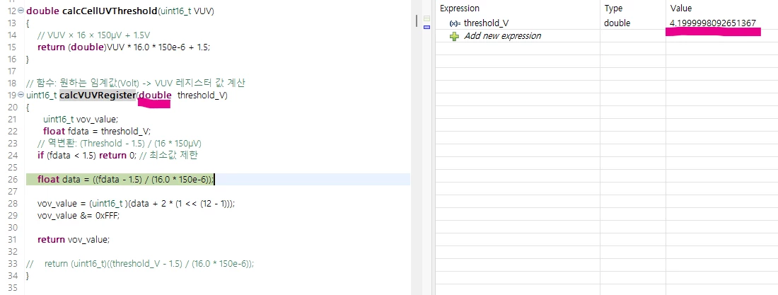

data values ​​of float type variables appear differently when debugging?
I'm trying to figure out why the value 4.2 is returned as -2 when passed as a function argument. Could you please also provide a solution? The MCU is an STM32F302VET.

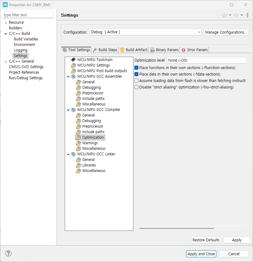

Is optimization turned off?
Ghofrane GSOURI
Sep 5, 2025 2:14 PM UTC
Hello @bupark007
As mentioned by @TDK  using high optimization levels can cause variables to be kept in CPU registers or even optimized away, making them difficult to inspect during debugging. To address this, try setting the optimization level to -O0 (no optimization) when debugging your code.
THX
Ghofrane
bupark007Author
Sep 8, 2025 2:40 AM UTC
Thank you for your answer. However, it is set in optimization mode.
I created a new project and confirmed that it would be output when I copied the above functions and debugged it. The current project keeps confirmed differently ~ I don't understand if STMCUBEIDE's own error ~

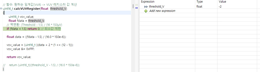

Sep 8, 2025 12:17 PM UTC
Does the if fdata < 1.5 line trigger? Maybe you're on a different statement.
Perhaps make a complete compile-able program that shows the problem.
The compiler is robust--unlikely to be any issues there.
bupark007Author
Sep 9, 2025 12:38 AM UTC
Yes~ ifdata <1.5 line is executed and 0 is returned.
By the way, if the factor receiving the function is changed from float type to double type, the real value is transmitted even if there is a slight deviation?
I've been doing Windows program for 20 years and I'm studying firmware program these days. There are a lot of difficult parts. Thank you for your sincere answer.
