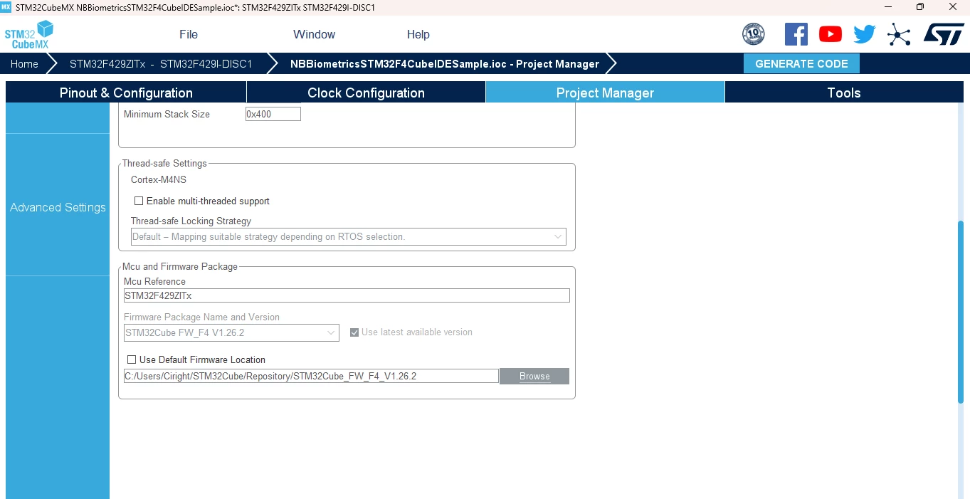

mƎALLEm
Dec 20, 2024 9:59 AM UTC
Check if V1.28.1 is available in this path: C:/Users/<user name>/STM32Cube/Repository/
Dec 20, 2024 10:33 AM UTC
mƎALLEm
Dec 20, 2024 10:48 AM UTC
I mean check that you have STM32Cube_FW_F4_V1.28.1 folder at this drive location: C:/Users/Ciright/STM32Cube/Repository/
Otherwise, check the checkbox: "Use Default Firmware Location":

mbarg.1
Senior III
Dec 21, 2024 1:28 PM UTC
This is NOT an ERROR.
It is a SWITCH between 2 options.
In xx.ioc editor,  project manager tab, check if "Use latest version" is checked.
If checked, every time you start edit an .ioc you can decide between 2 options, old version or new version
