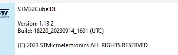

I am working with what I think is the latest STM cubeMX:
But, I am hitting an issue contantly that during debugging, on certain "lines of code" the debugger hits some unexpected condition, and then decides to exit, automatically stopping the debugging perspective.

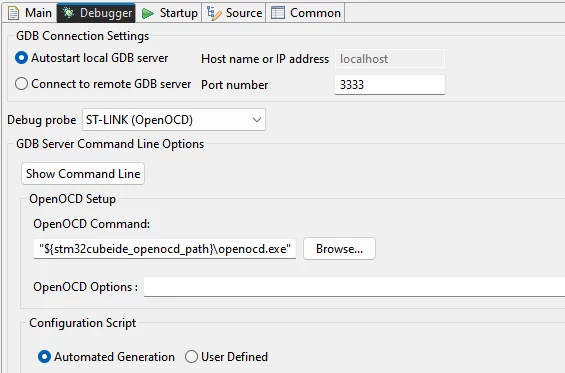

My debug settings are this:
And it -very specifically- happens when stepping in certain parts of the code. Presumably GDB tries to read some variable that it cannot access, or tries to disassemble some code, Idk, but in any case, the debugger fully quites

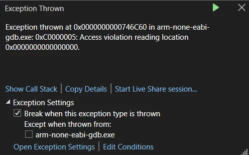

    So I quickly tried some things:
    - Ran openOCD in seperate window => But it doesn't seem to be openOCD that is the problem

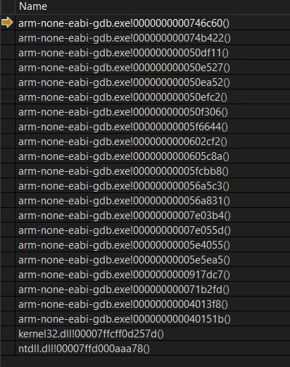

    - Attached to arm-none-eabi-gdb.exe through visual studio and checked for execeptions:
    GDB indeed crashes
    I have no symbol information of the gdb build. But it's clear that the shipped GDB has issues, .. and crashes when stepping through certain lines of code!

    I ended up replacing C:\ST\STM32CubeIDE_1.13.2\STM32CubeIDE\plugins\com.st.stm32cube.ide.mcu.externaltools.gnu-tools-for-stm32.11.3.rel1.win32_1.1.1.202309131626\tools\bin\arm-none-eabi-gdb.exe --version with the one from https://developer.arm.com/downloads/-/gnu-rm (gcc-arm-none-eabi-10.3-2021.10-win32.exe) and the crashes went away ...
