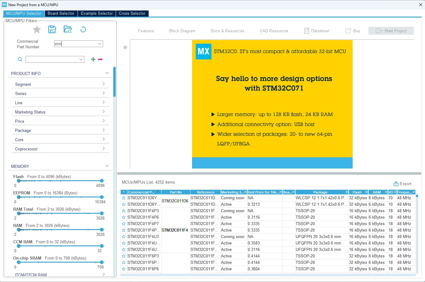

Here, CubeMX opened directly:

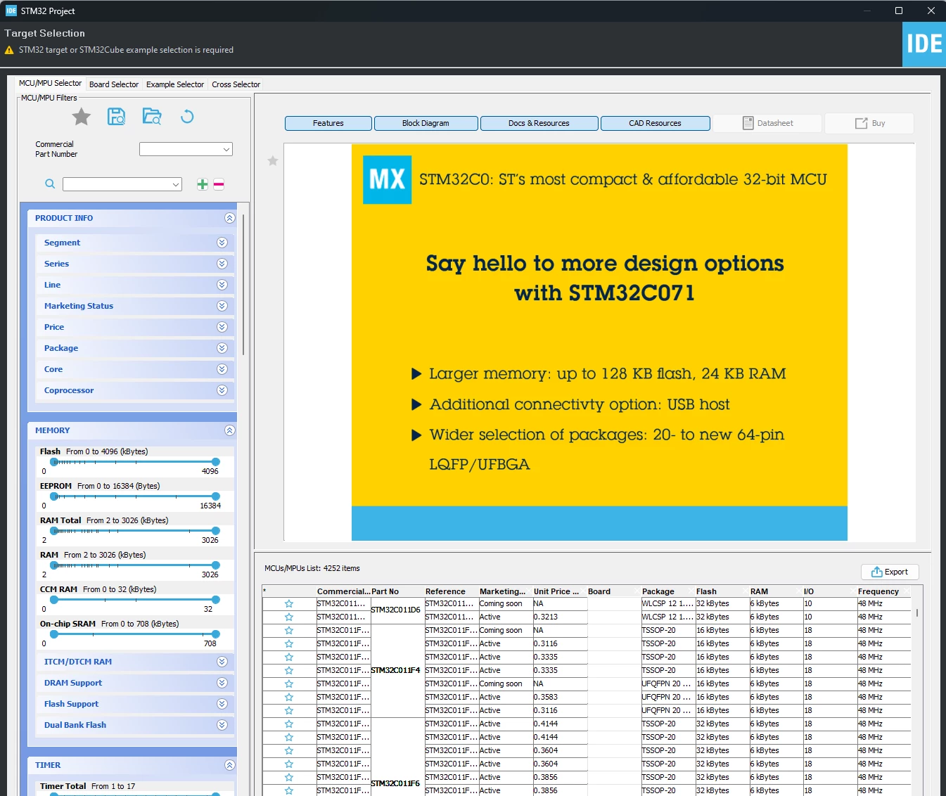

and here opened from CubeIDE:

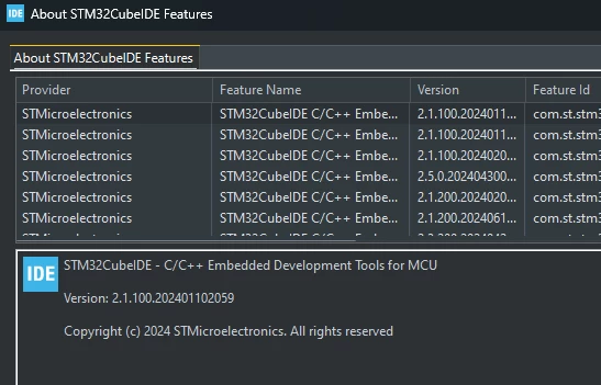

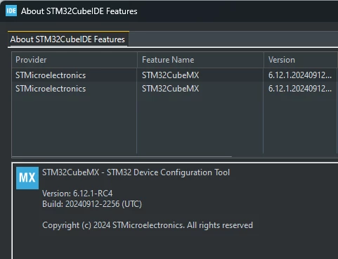

My CubeIDE version:
