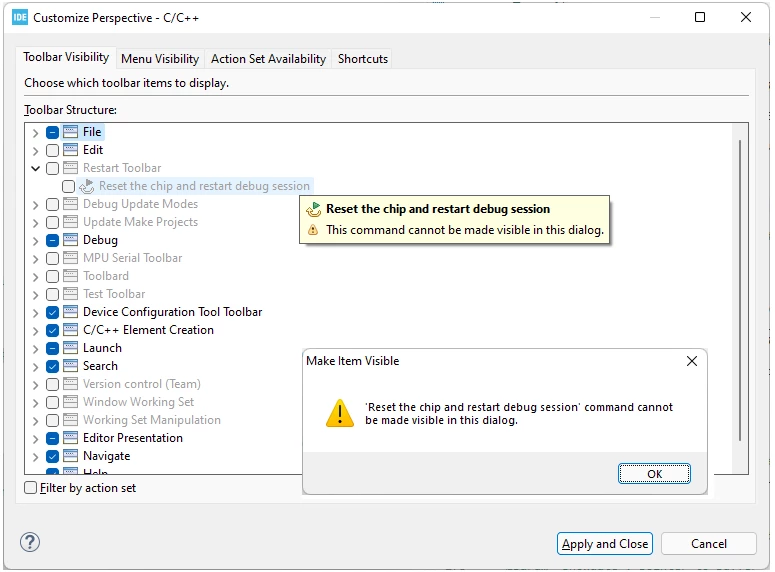

How to be in debug window? I've been doing debugging, so I should be in debug mode, but I'm not seeing that button.
I also try Customize Perspective, and got this message when click on "Restart Toolbar" box.
0693W00000JPA9oQAH.pngWhen I click on "Reset the chip..." box, I got this0693W00000JPABoQAP.pngHow do I fix all of this?

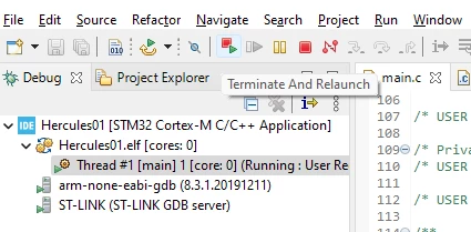

BTW, I get Terminate and Relaunch button in Debug perspective. This button will restart the processor from beginning. However, it re-programs the processor first.
0693W00000KZbS8QAL.pngIs there another button to restart (such as activating the reset pin of the processor) without re-programming the processor?
Harvey White
Harvey WhiteBest answer
Senior III
Feb 17, 2022 10:00 PM UTC
In the picture you have submitted:
Red block with green arrow under "Navigate" label, halts, recompiles, reloads, then executes (like F11). that's the one you have highlighted.
Green arrow with yellow arrow circling under it. Found under the refactor label. This resets the processor without reloading it. That's the one you want. Fifth icon from the left.

Yeah, I got it. It was right under my nose. Thanks every1.
