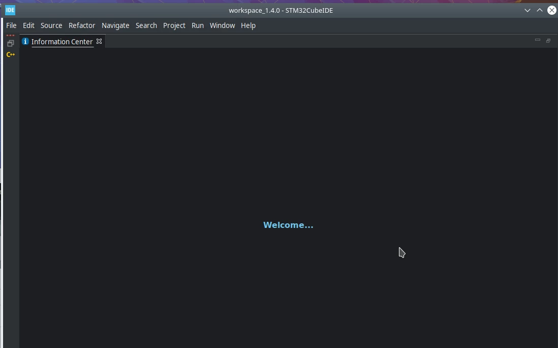

CUBEIDE Repair
0693W000005BS2gQAG.pngI need help.
Please look at the picture below.
What should I do?
Environment: KDE 18.04LTS
1 reply

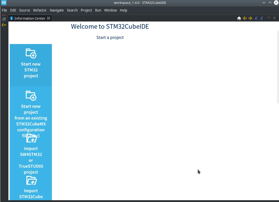

I found the answer.
Please install "webkitgtk"​ >> version 2 or 3
command
  1. sudo apt-get update -y
  2. sudo apt-get install -y libwebkitgtk-3.0-0
  3. sudo apt-get update -y
  4. sudo apt-get upgrade -y
Goold LUCK... HAHA!
