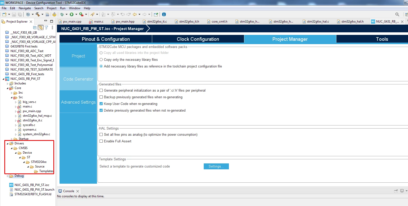

CubeIDE reference to driver files dissappeared
I included them as reference, but now after restart of cube they dissappeared.
See picture added. Its 1.12.0
2 replies
Pavel A.
December 9, 2023
Click on the top rectangle, PROJECT.
December 9, 2023
If you want to add files, add them in a path that CubeMX doesn't control.
