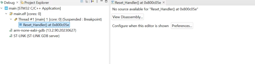

I have a Makefile based project that I imported to CubeIDE. I am able to build it smooth, however when i am trying to launch a debug window I am not able to see the source code and it only shows 2 buttons saying "View Disassembly" and Preferences tab.
Unlike the one's shown online I am not getting an option to load the source file by browsing my file system. What am I doing wrong and how to load this??

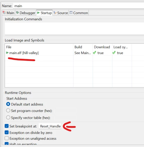

The below is my debugger view (I put a breakpoint at Reset_Handler hence the halt)
Please help me with the problem as it's very hard to debug with the assembly view. please note the view is not loading when the function is entering C files too, i.e., from Reset Handler the PC jumps to SystemInit which here is a C file but even for that I am not able to see the load.

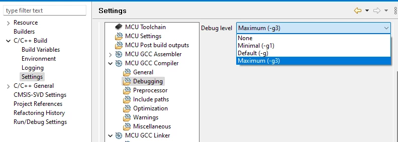

Did you build with debug info? - Do you mean my optimization level? Yes, I had -O0 and added
No. You need a -g to include debug info in the ELF file:
https://gcc.gnu.org/onlinedocs/gcc/Debugging-Options.html#:~:text=Level%203%20includes%20extra%20information%2C%20such%20as%20all%20the%20macro%20definitions%20present%20in%20the%20program
Default for CubeIDE is -g3:

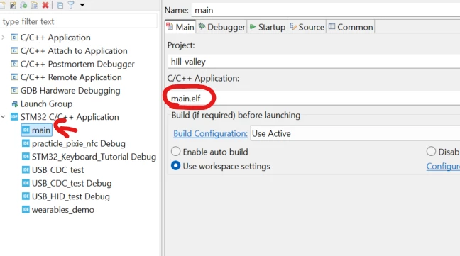

Show how you do the launch
I created a new debug configuration by going to Run -> Debug Configurations
And to launch I simply clicked Debug As -> STM32 C/C++ Application and it was able to launch it.

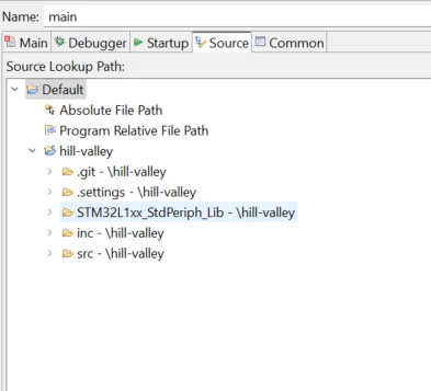

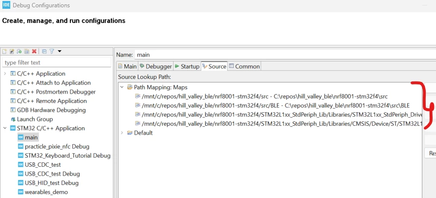

@unknown Thanks for the reply. There seems to be a mismatch in the cross referencing of the file path as my PC has WSL enabled and I need to add the mapping translations for the file path in the debug configuration.
After giving the file paths and the mainly enabling "-g3" to the makefile I am able to get the debug views correctly.
Thanks alot for your help, I will close this.
