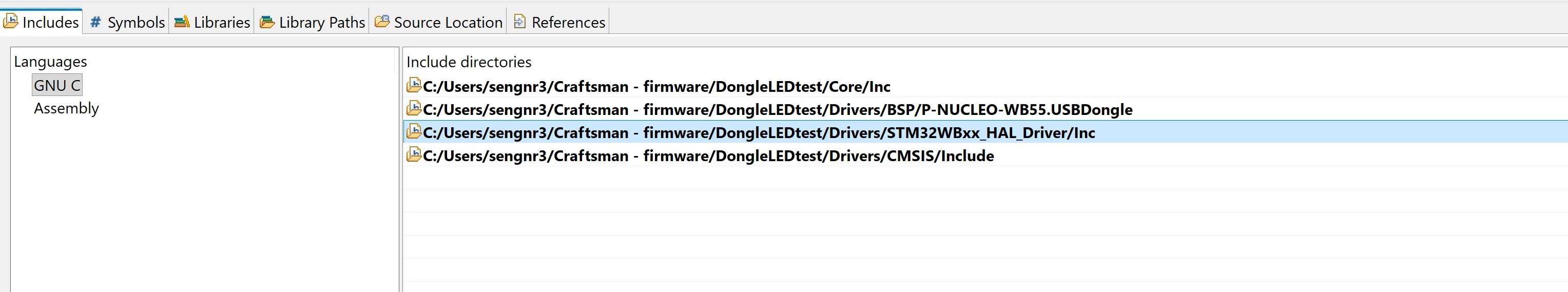

I’m trying to build the LED example for the P-NUCLEO-WB55.USBDongle.

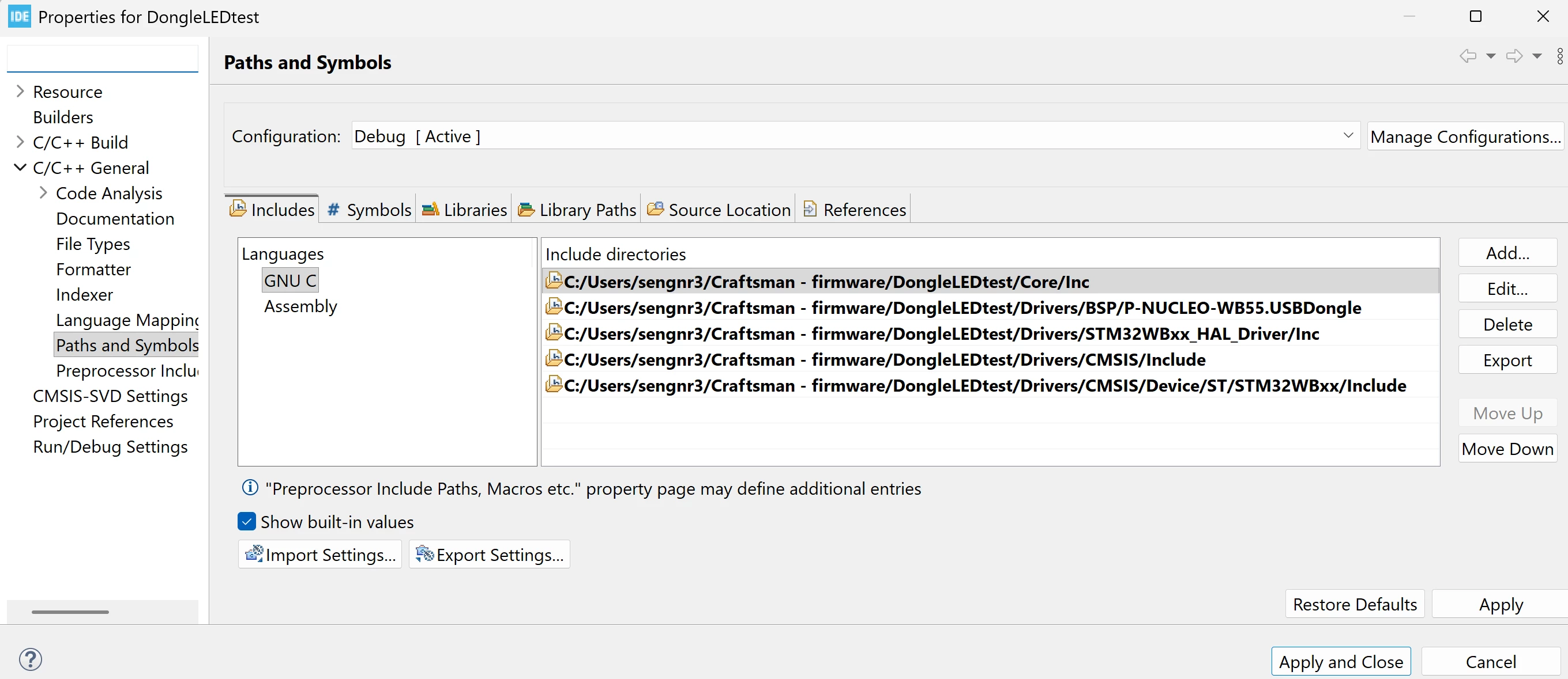

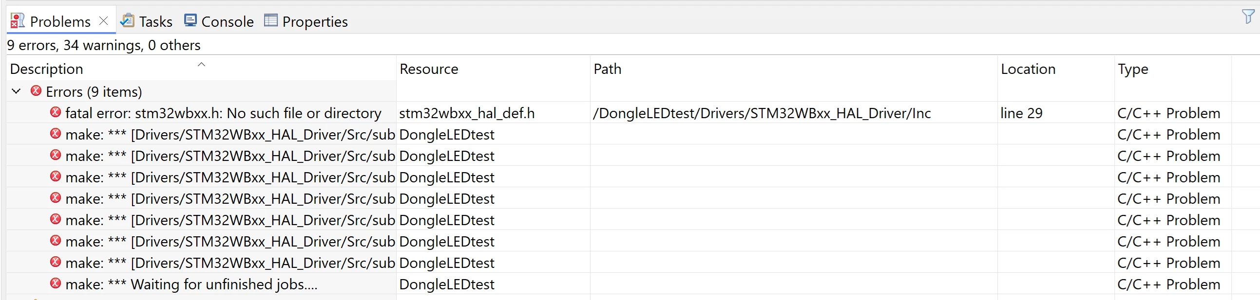

I have included all the necessary include & source paths yet when I try to build it exits with the following,

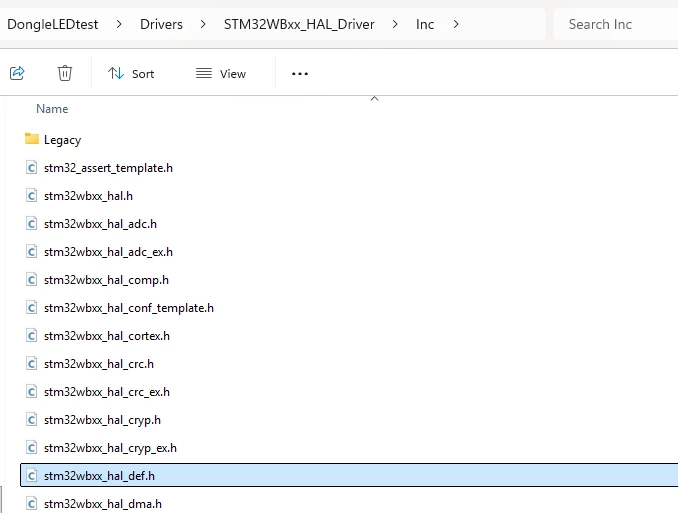

This file does actual exist though,
and its location is in the paths list,
What am I missing here?

Note the error is talking about not finding stm32wbxx.h, not the file you are showing in your screenshot. That file was found just fine, because the error is from trying to compile it. The Console tab output is typically more useful than the “Problems” tabs.
Try removing spaces from the path.

Thanks yes I didnt have stm32wbxx.h in my path but now its complaining about RTC typedefs for example,
../Drivers/STM32WBxx_HAL_Driver/Src/stm32wbxx_hal_timebase_rtc_alarm_template.c:92:8: error: unknown type name 'RTC_HandleTypeDef'
arm-none-eabi-gcc "../Drivers/STM32WBxx_HAL_Driver/Src/stm32wbxx_ll_crs.c" -mcpu=cortex-m4 -std=gnu11 -g3 -DUSE_HAL_DRIVER -DUSE_STM32WBXX_USB_DONGLE -DCORE_CM4 -DDEBUG -DSTM32WB55xx -c -I"C:/Users/sengnr3/Craftsman - firmware/DongleLEDtest/Core/Inc" -I"C:/Users/sengnr3/Craftsman - firmware/DongleLEDtest/Drivers/BSP/P-NUCLEO-WB55.USBDongle" -I"C:/Users/sengnr3/Craftsman - firmware/DongleLEDtest/Drivers/STM32WBxx_HAL_Driver/Inc" -I"C:/Users/sengnr3/Craftsman - firmware/DongleLEDtest/Drivers/CMSIS/Include" -I"C:/Users/sengnr3/Craftsman - firmware/DongleLEDtest/Drivers/CMSIS/Device/ST/STM32WBxx/Include" -O0 -ffunction-sections -fdata-sections -Wall -fstack-usage -fcyclomatic-complexity -MMD -MP -MF"Drivers/STM32WBxx_HAL_Driver/Src/stm32wbxx_ll_crs.d" -MT"Drivers/STM32WBxx_HAL_Driver/Src/stm32wbxx_ll_crs.o" --specs=nano.specs -mfpu=fpv4-sp-d16 -mfloat-abi=hard -mthumb -o "Drivers/STM32WBxx_HAL_Driver/Src/stm32wbxx_ll_crs.o"
92 | extern RTC_HandleTypeDef hRTC_Handle;
Now I know the definition of this exists in stm32wbxx_hal_rtc.h  which exists in the ….\DongleLEDtest\Drivers\STM32WBxx_HAL_Driver\Inc folder which is in my path list.
