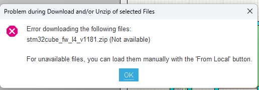

i just installed CubeIDE / MX on a brand new Computer. I am running Windows 11.
Both IDE and MX have a problem with downloading "software packages" The are extremly slow and after an hour i get an error message. I am not able to work with that behaviour.
I checked the Firewall / Disabled it. Internet connection is there, and yes it is fast enough. All other programs works just fine.
Its just the ST Tools.
Is there any known issue with windows 11?
Hope someone can help me, because i would like to continue with my projects.

I think the cube package F4 V1.18.1 is no more available for download from ST website.
The oldest version available is at this date is V1.23.0.
So either you configure your project to point to the latest version of the HAL or open an ols ticket to get F4 V1.18.1.
