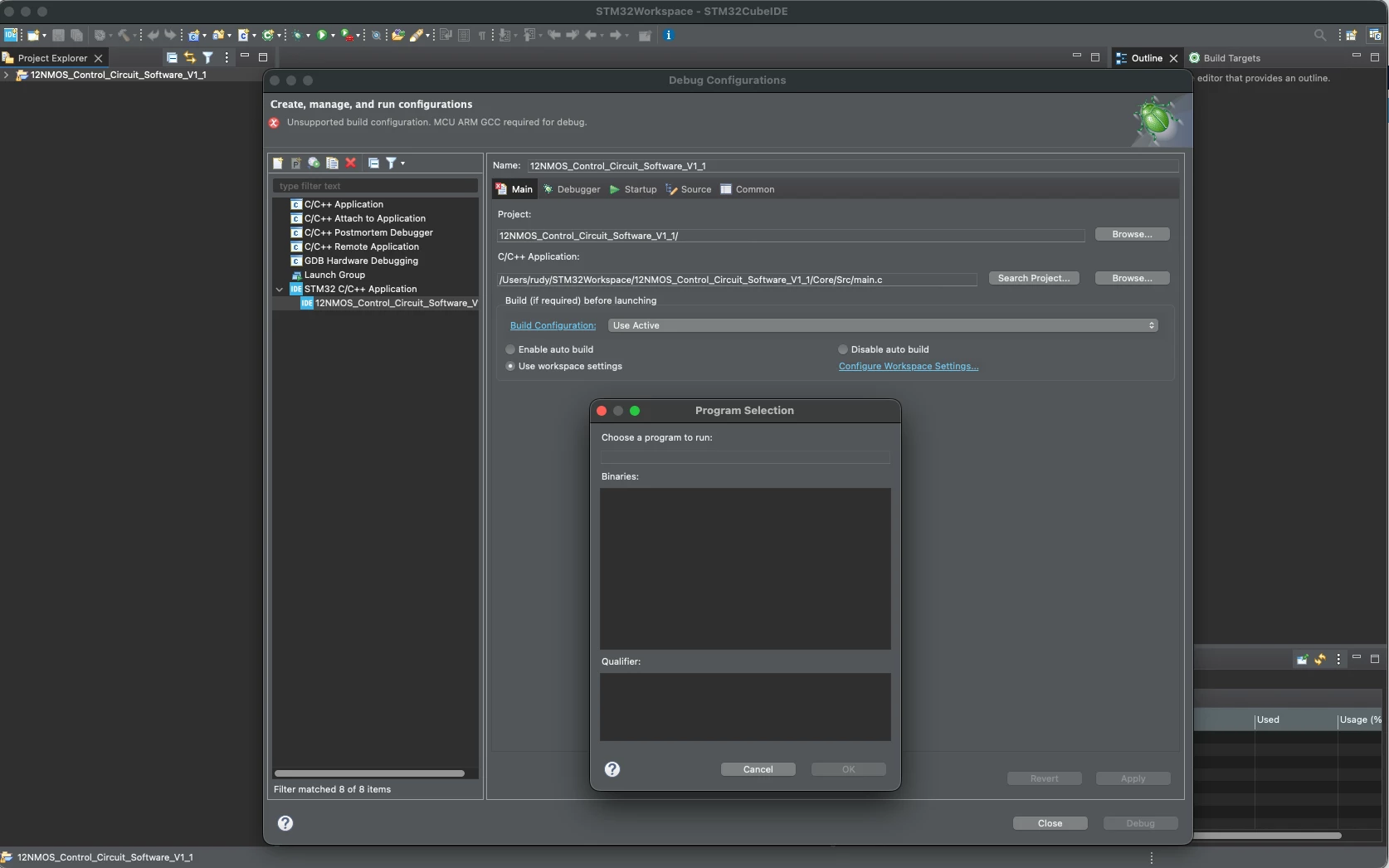

Hi all,
I would like to load an STM32CUBEMX program in STM32CUBE IDE on my MacOSX but I can’t set the debug configurations. I simply can’t see the project that I am loading. Is this a known issue? See below the screenshot from CubeIDE:

What MacOS version are using? please note that the supported operating systems and architectures required by STM32CubeIDE are:
  • Windows® 10 and 11, 64 bits (x64)
  • Linux®: Ubuntu® LTS 22.04 and LTS 24.04, and Fedora® 43
  • macOS® 15 (Sequoia), macOS® 26 (Tahoe)

Thank you for your quick response. I am using a macbook M1 pro with Tahoe 26.4 and STM32CubeIDE 2.1.1.

You have to build project first in order to set debug configuration.
