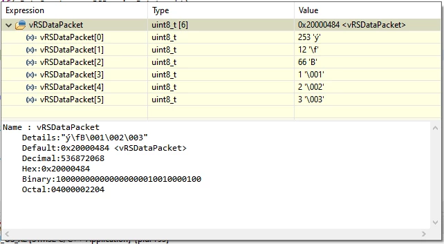

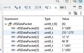

Hi dears
I saw a bug in live expressions. So I attached some images.
As you see data's location in Arrey shifted. the correct value is the left one.
Thank you

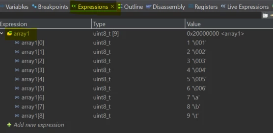

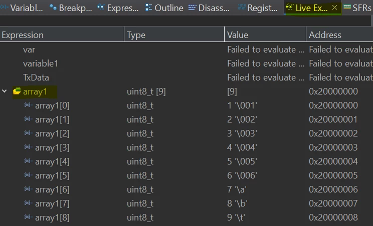

    Hello @MTora.1 and welcome to the community,
    Could you, please, provide how did you defined and used the array variable. In fact, the issue is not reproduced from my side and  data's location in the Array is the same in Live Expression and Expression view ,as shown in the following screenshots:
    Thanks,
    Rim

    Seen same behaviour with STM32CubeIde 1.14.1...
    In particular:
    - results (right column) are shifted in position respect to variables names (left column);
    - adding a probabily-shown-wrong variable twice shows two different results.
    This is very frustrating, since you cannot really trust what you see in Live Expressions.
