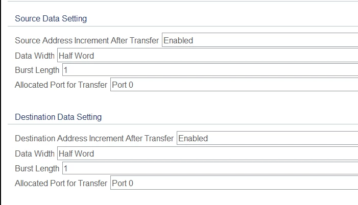

Hi all,
I'm using STM32Cube IDE (version 1.15.1 Build: 21094_20240412_1041 (UTC)) and have the STM32H573 chip with the LinkedList feature.
Unfortunately the code generation of the linked list does not work properly and forgets to set some config settings.
The LinkedList is a List with 3 nodes.
My third node is a 2D sorting node which should be set to:
But these lines are missing:
pNodeConfig.Init.SrcInc = DMA_SINC_INCREMENTED;
pNodeConfig.Init.SrcDataWidth = DMA_SRC_DATAWIDTH_HALFWORD;
pNodeConfig.Init.DestDataWidth = DMA_DEST_DATAWIDTH_HALFWORD;
The generated code looks like this:

It seems like the second node overwrites it and the third node doesn't.
Am I missing something or is it a code generation problem?
Thanks in advance for any insights.

    Hello @joker and welcome to the Community :)
    Thank you for having reported this point.
    I confirm this issue and submit an internal ticket (number 181922) in order to fix this.
    Thank you for your contribution.
