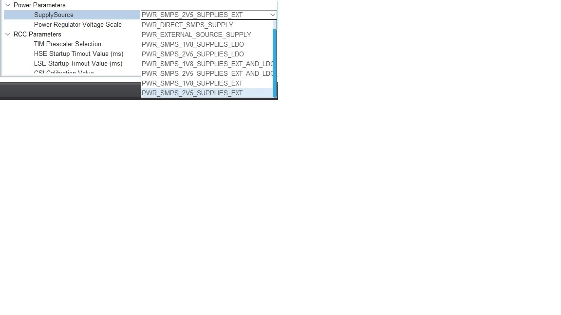

The IOC configurator for the STM32H755 lacks an option in the RCC configuration
Power Parameters -> SupplySource
The PWR_DIRECT_SMPS_SUPPLY setting is missing.
This setting is required for the NUCLEO-H755ZI-Q board which default supply configuration:
the SMPS feeds the core without using the LDO.
Regards.

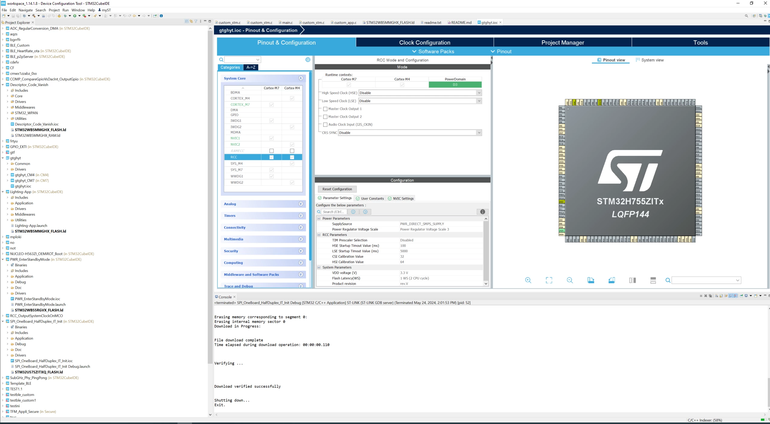

zeboss49Best answer
Senior
thank you for this pertinent remark.
But there's a very simple explanantion.
The screen shot was taken after I reduces the core frequency to 400 MHz.
Setting the core frequency above 400 MHz makes the setting disappear.
Where I was wrong was thinking of that as an issue.
It's a normal behavior, running above 400 MHz does rquire to use the LDO.
Thank you again for your answers.
May this post help other users to avoid them doing the same mistake.

zeboss49Author
Senior
your screen shot is from 1.14.1 not 1.15.1.
The attached screen shot to my original post shows that the item is missing.
I upgraded to 1.15.1 form a rather old version because the IOC has strong issue rendring the H755 configuration (blank screen).
Then I created a project for the Nucleo board and got a warning saying that the power option (SMPS DIRECT) was not valid.
Do you suggest that I should fully remoce CubeIDE and do a fresh install ?
In this case, is backuping the workspace, clearing the folder, installing a fresh copy and restoring the workspace form the backup a safe solution?
Thx
zeboss49Author
Senior
the latest version of CubeMX does show the option.
