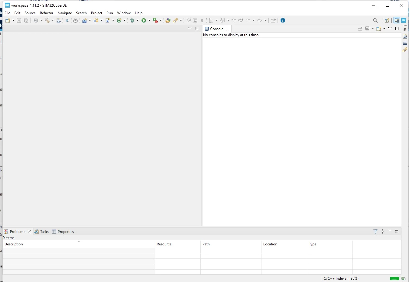

CubeIDE is not opening the generated code
Hi! This is my first project using stm32f407 board, After all the configuration, I generate a code on cubeMX but cubeIDE gives me an empty page. Sorry if the question is stupid, I am not familiar with this software0693W00000aIH0rQAG.jpg

Hello @LimoGr​
Try right-clicking the C/C++ perspective icon in the upper right corner and click reset.
Alternatively, click Window > Show View > Project Explorer, and browse from there, import your projet if need be.
Also, you might want to use CubeMX directly from CubeIDE. New > STM32 Project will eventually lead you to CubeMX perspective and you can directly generate your code from there.

It worked! Thank you!
