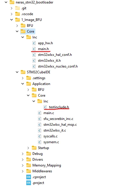

I have a header file that is outside my projecto folder, main.h (this was imported from the 1_Image_BFU example). And the header cannot find the header  inside my project even though I have included in the path.
The structure is as follow:

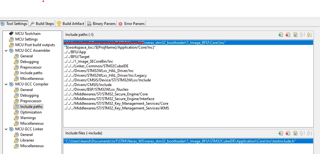

In the main.h I added the #include "testinclude.h", and added the following path in the projcet properties:
However when I try to compile I get an error that the file cannot be found.

The include path indeed looks invalid. It should contain 1_Image_BFU/STM32CubeIDE/Application/Core/Inc, not 1_Image_BFU/Core/Inc

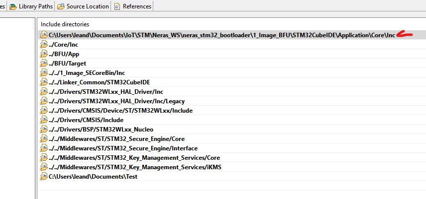

Dear @Pavel A. thanks for the reply.
Sorry about my picture before, but actually the include regaring that file was the second line, this one below:
However just to make sure I added the complete path as below:
And got the same result, and to avoid error I used the folder explorer from the pop box.

So now the 1st item likely is good. Note that 2nd and following items have "error" icons on them. This means the IDE cannot find them. Note the warning about avoidance of relative paths displayed at bottom of the incudes dialog. It is not for nothing.
