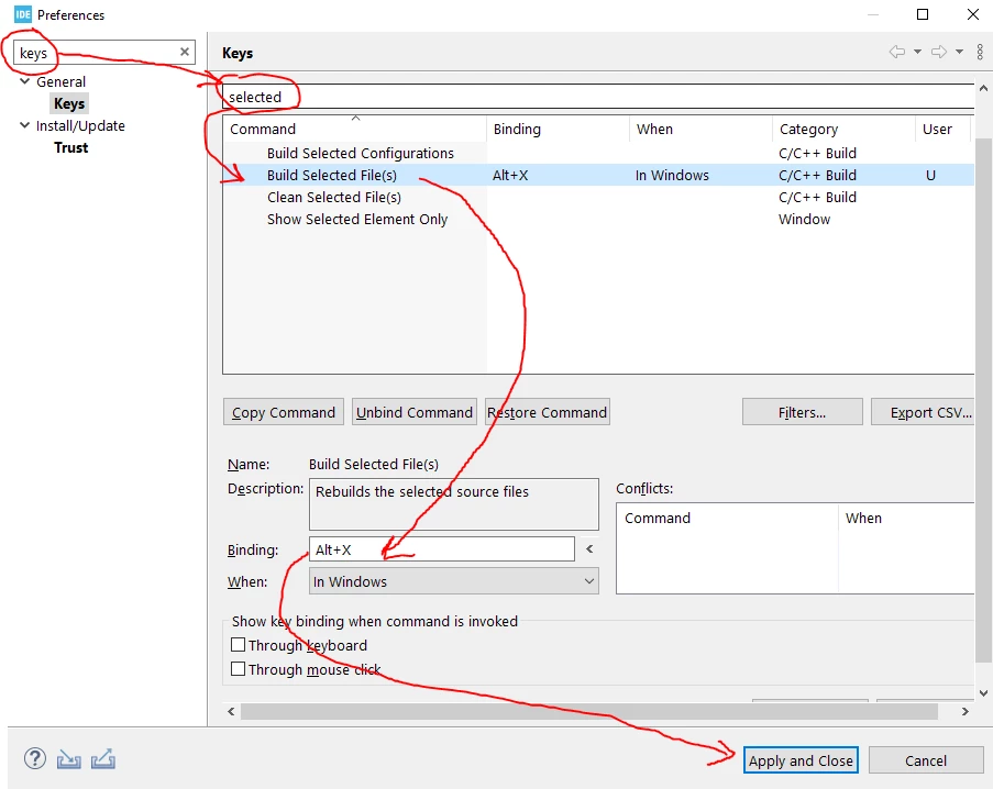

Window > Preferences > [type 'keys'] > [type 'selected']
Click field 'Binding' and press desired keys combo.
