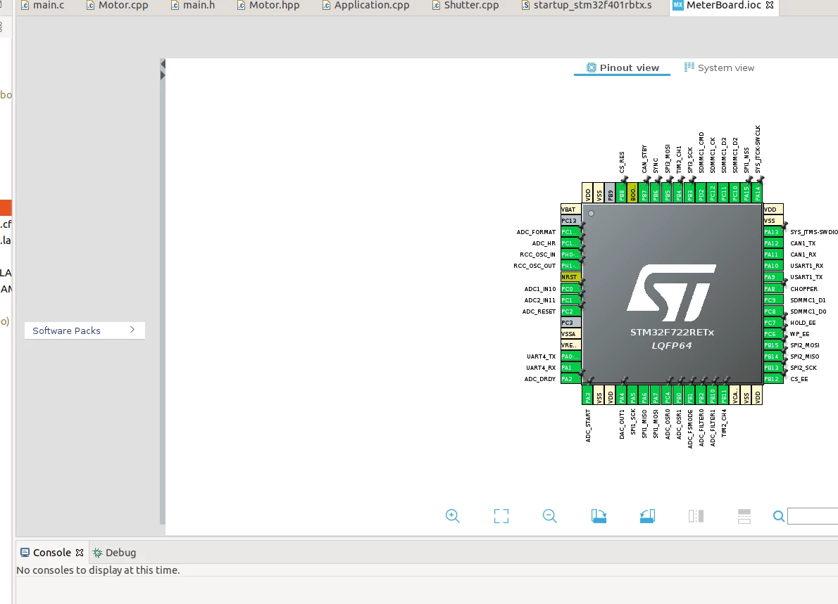

OK, here you are. I ran the system twice, once when I waited for it to calm down then opened the .ioc, and it behaved correctly. The other where I rebooted first, then opened the .ioc as soon as the project pane appeared, and it hung. I also include a screenshot of the hung IDE. The pin-out pane appears but the peripherals pane to its left does not. I note that the fault seems to occur only after a reboot, once a succesful opening occurs, subsequent IDE runs within that Linux session work OK.

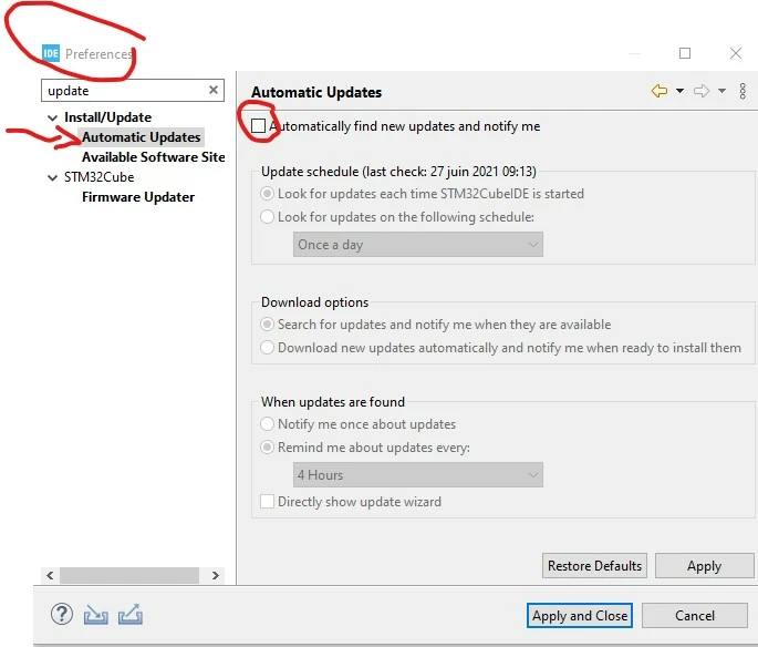

1) Is disabling background updates check is helping ? (Windows > Preferences)
Looking at traces:
1) Both are showing remote connections to Eclipse & co update sites
2) Hang and idle traces are somehow same but having lines interleaved
3) If idle trace sounds 2 minutes are spent doing handshake with remote servers (what's a while !!!)
=> Cutting such under the hood update checks may help I guess
2) Possibly 4Gb ram is too few ...

Thanks. I'm trying setting update checks to once a week.

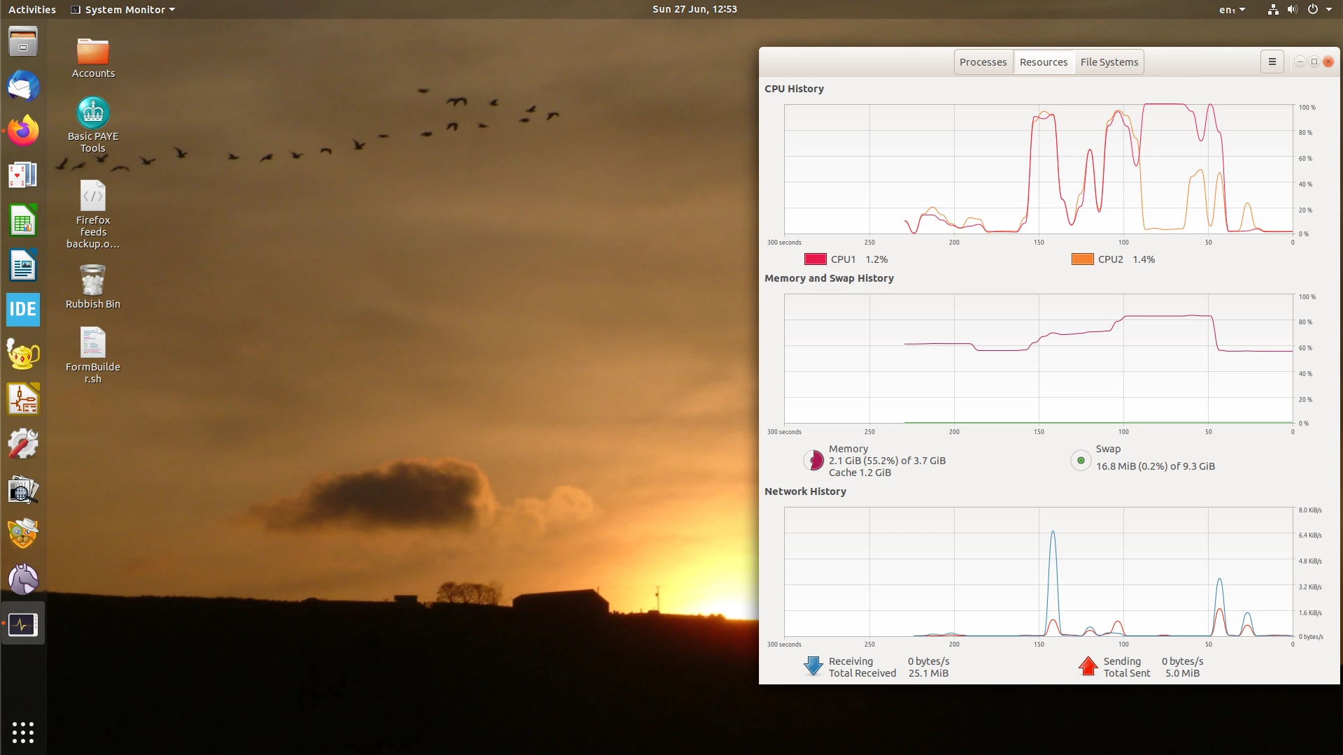

Here is a screenshot of the system monitor. I started the IDE at about the 170 second mark, and opened the .ioc somewhere around 120. At around 80 it went into the hung state (one processor saturated), and at 60 I clicked the close cross. The perspective changed back to C/C++ immediately but there was some delay before the IDE window closed.

I have the same issue. If my PC is under load them opening .ioc hangs. Take a look at left panel on the screenshot. It is empty and IDE hangs. I have to calm down PC and to restart IDE to open .ioc file. I saw this behavior in version of IDE 1.3, 1.4, 1.5, 1.6, 1.7. They all behave the same.
