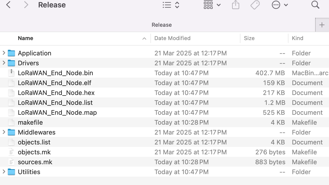

CubeIDE generate Too Big BIN file for STM32WL
Hi
We re trying to compile LoRaWAN_END_Node project from STM32WL Cube library. CubeIDE generate 402 MB  bin File. Can someone from STteam  look into this.
MCU STM32WLE5CC
Mac Verion 1.0.3
WL 1.3.1

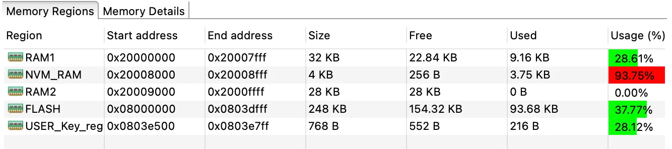

Pavel A.
Mar 28, 2025 1:57 AM UTC
This is because the executable contains several data blocks at addresses very far away: 08000000 and 20008000.
The tool must output a single flat binary so it just does its best and fills the huge hole(s). Bottom line: the plain .bin file is not optimal format for this program. Why not just use the .hex?
