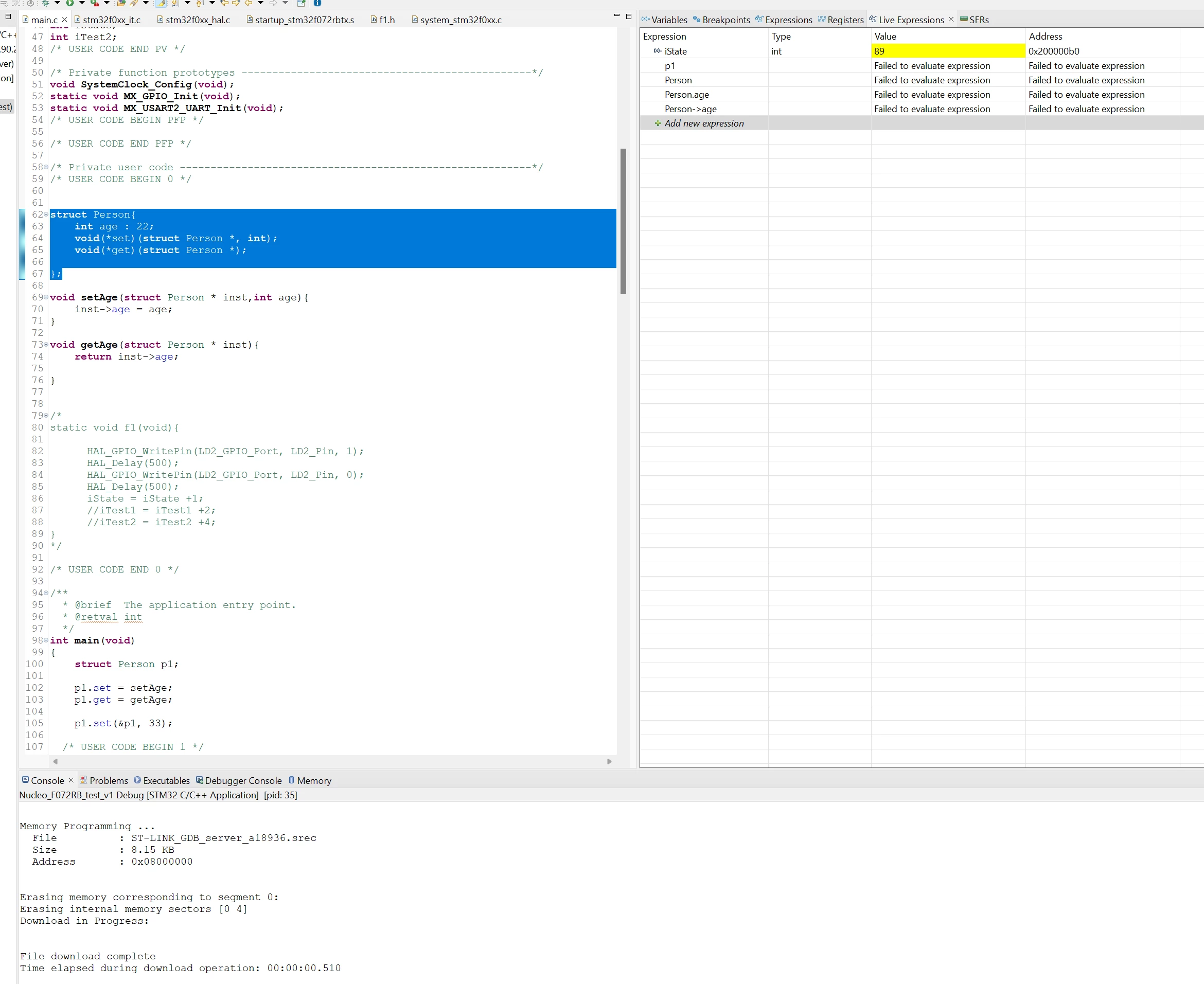

Hello community,
I just started to work with CubeIDE.
CubeIDE offer a functionality to watch the variables during debugging in the LiveExpression-TAB.
My issue is, that I don't know how to watch the variables defined in functions:
Eg: Variable i inside function f , see second picture.
static void f1(void){
	int i = 3;
	HAL_GPIO_WritePin(LD2_GPIO_Port, LD2_Pin, 1);
	HAL_Delay(500);
	HAL_GPIO_WritePin(LD2_GPIO_Port, LD2_Pin, 0);
	HAL_Delay(500);
Thanks in advance for any support you can offer.

Dec 2, 2024 9:16 PM UTC
Hello STM_Thirty2,
thanks a lot for your support!
I created a global Struct 'Person'.
But still can't acess the struct in debug-mode via LifeExpression.
What am I doing wrong?

Dec 3, 2024 4:30 AM UTC
The struct object is global but your p1 is still a local variable you made it in the main function. This will still work through the life of your program because technically the program always be in the main function , so your issue now is probably you are not really doing anything with p1 , so the compiler is optimizing it out.
try this:
volatile struct Person p1;
Additionally make sure you have live expressions enabled:
"If you feel a post has answered your question, please click ""Accept as Solution"""
Dec 8, 2024 4:03 PM UTC
STM_Thirty2,
thank you very much for your help, now it works!
