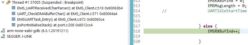

CubeIDE debugger stops always in same source code line even with erased breakpoints.
once I was in debugging session and debugger stopped at certain source code line.
After this event, debugger always stops in the same line, even with breakpoints removed.
Only setting "Skip All Breakpoints" helps, but I cannot stop at regular breakpoints, which is unusable.
Where can I delete of find the problem inside CubeIDE ?
I've already recreated debug config, cleaned the project - nothing helps...
Thanks in advance.

Turn OFF the debugger, restart IDE, and turn ON debugger. In may case it always help.

It worked for me: Made Clean and compile again
