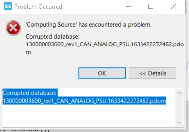

cubeIDE, Corrupted database?
This happened, i am still able to compile and debug code.
But all the autocomplete (Ctrl+space), funcion linking (ctrl+ left click) and search tools....all nice coding aid features are gone.
what is causing this, is there any way of fixing it without erasing the entire workspace?

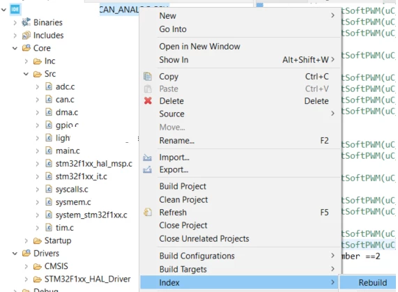

TDKBest answer
October 18, 2021
You could try rebuilding the index and refreshing files. Right click project -> Index -> ...
Doesn't appear to be a common error.

Javier1
Javier1Author
Principal
October 19, 2021
it worked, thanks.
0693W00000FD15xQAD.pngHappened to me 3 or 4 times already... only now annoyed me enough to do something about it
