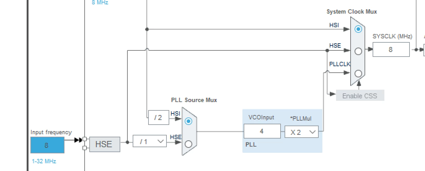

CubeIDE Clock Editor won't allow HSE selection with external clock
STM32CubeIDE Version: 1.13.0; Build: 17399_20230707_0829 (UTC).

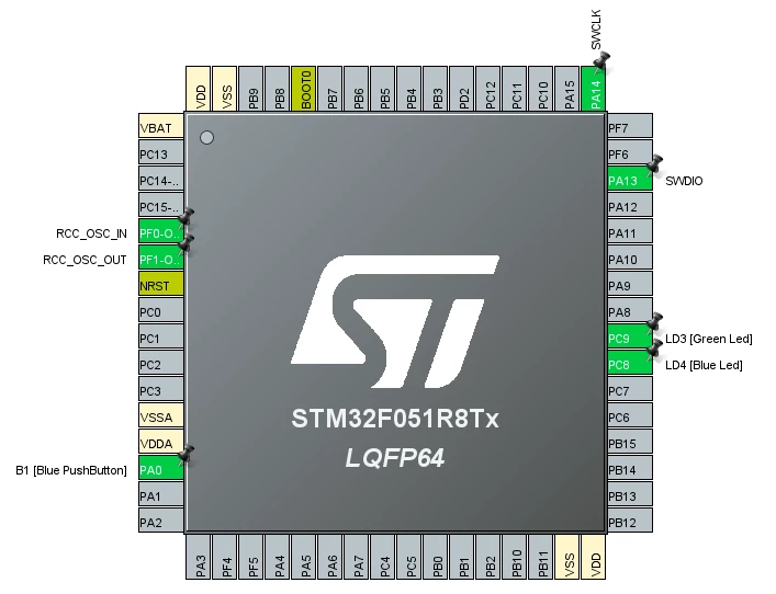

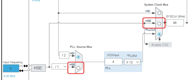

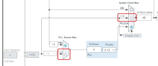

It seems that the IDE greys-out the options to use HSE:

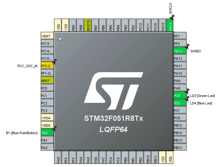

Unless both PF0 is configured as RCC_OSC_IN and PF1 is configured as RCC_OSC_OUT:
Surely, it should be possible to use HSE when only PF0 is configured as RCC_OSC_IN - as shown in the Reference Manual:
TDKBest answer
November 27, 2023

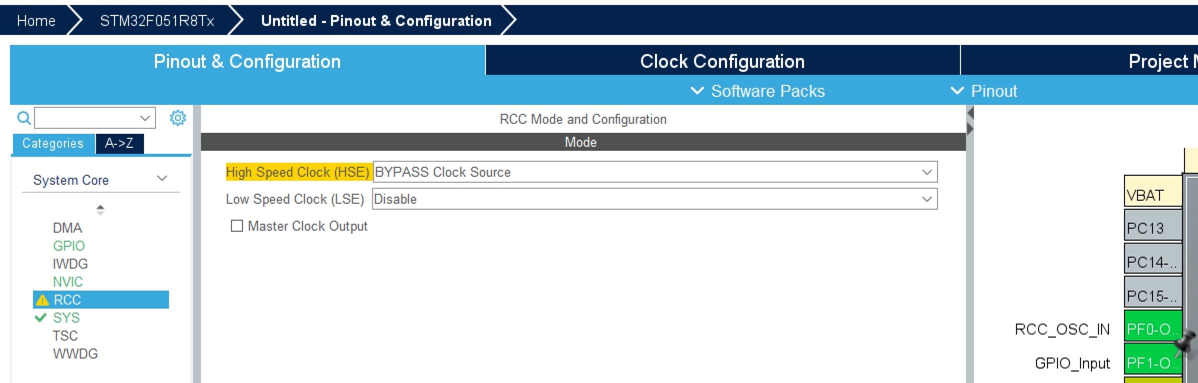

You have to enable bypass mode under RCC. Just reserving the pin (i.e. the pin is yellowed out) isn't enough.

Andrew Neil
November 27, 2023
Ah, right - that does it.
Seems a bit clunky, though.
The 'resolve clock issues' didn't suggest this if I selected HSE and then switched back to just PF0 in clock mode.
And this is the IOC generated specifically for the F0-Disco - which, by default, has no crystal fitted and gets its clock from the on-board STLink.
Andrew Neil
November 27, 2023
It does manage to automatically set 'Crystal/Ceramic resonator' when you configure both PF0 and PF1 - so why can't it automatically set 'Bypass' when you only configure PF0 ?
