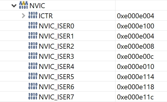

[CubeIDE BUG] NVIC_ISER1-NVIC_ISER4 have wrong addresses at SFR view for NUCLEO F411RE
Using the Cortex-M4 Devices Generic User Guide at page 219 it is written the address of ISERs
0xE000E100- 0xE000E11C NVIC_ISER0- NVIC_ISER7
While I was trying to debug my program I realized that these addresses in the IDE are wrong as you can see in the picture
0693W000007BjXeQAK.pngI hope that bug could be confirmed and fixed
If there is another place that I can post it please direct me to that.
STM32CubeIDE Version: 1.5.1 Build: 9029_20201210_1234 (UTC) Windows 10

This issue should be fixed in CubeIDE 1.7.0.
ST Internal ticket reference 109845.

I have the same problem with Version: 1.6.1, Build: 9958_20210326_1446 (UTC)
