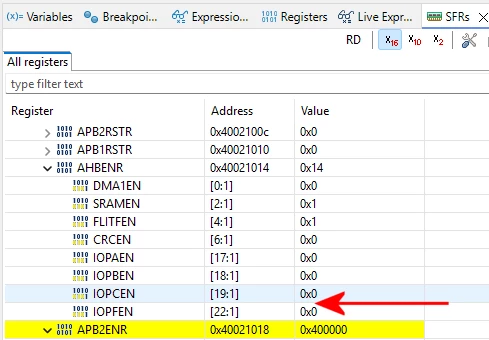

CubeIDE 2.1.1: AHBENR missing IOPDEN for STM32F030R8T

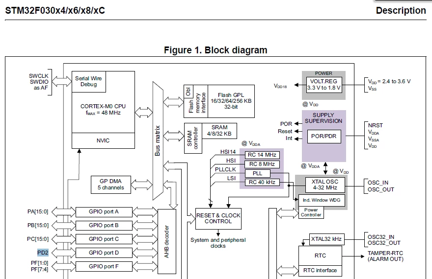

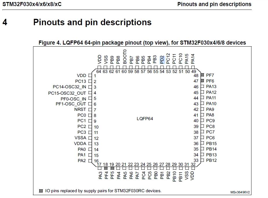

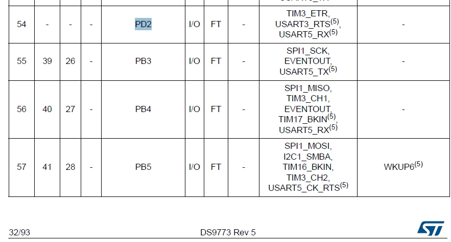

STM32F030R8T - as on the Nucleo-F030R8

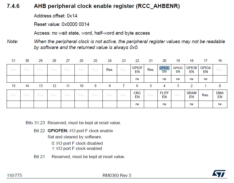

PD2 should be present:

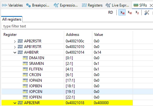

Therefore GPIODEN should be present at RCC_AHBENR[20]:
But it’s not present in the CubeIDE SFRs view:

Hello ​@Andrew Neil
Let me thank you for bringing this issue to our attention.
An internal ticket has been created and submitted to the dedicated team (Ticket Number: CDM0063714)

Hello ​@Andrew Neil
After checking, the PD2 Pin is supported in STM32F030R8T.
Thanks.
Mahmoud
Andrew Neil
Jun 22, 2026 10:16 AM UTC
Yes, I know the pin is supported - it’s the bit in CubeIDE’s display of AHBENR that’s missing!
IOPDEN should appear between IOPCEN and IOPFEN
The full value of the AHBENR register is correct - it’s just that the decode of the IOPDEN bit is missing.
