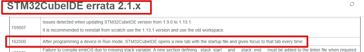

CubeIDE 2.1.0: Still opening spurious files when starting a debug session
Title edited to state the issue being discussed.
Really? After all these years?

Hello @padawan ,
According to an internal information that seems to be an Eclipse related issue. We need to wait for the Eclipse fix before to integrate it in CubeIDE.

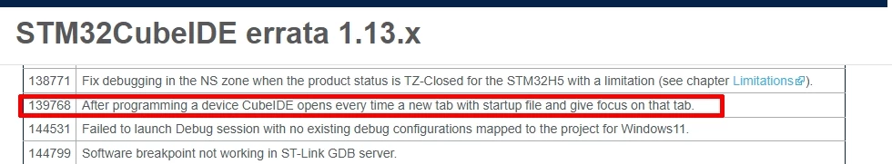

Feb 27, 2026 3:00 PM UTC
Yes.
This isn't a new issue, just the first time it's in the errata.
Acknowledging the problem is the first step. This is progress.

Mar 2, 2026 3:41 PM UTC
Cannot you solve yourself or try to mitage it somehow?
I suggested in the past to at least make the file temporarily read-only until the run/debug operation has not hit the main so that random file is not changed if some input is issued while the random file is opened. That seems an "easy" solution at least it mitigates some annoying

Hi Andrew,
if i have to work a round a bug, there is still a bug ;)
And: this bug is very old (and still a bug, not a feature).
At the first postes about this bug they say, they solve it "asap"
Now, over 5 years later, i think "asap" is a long time. :)
