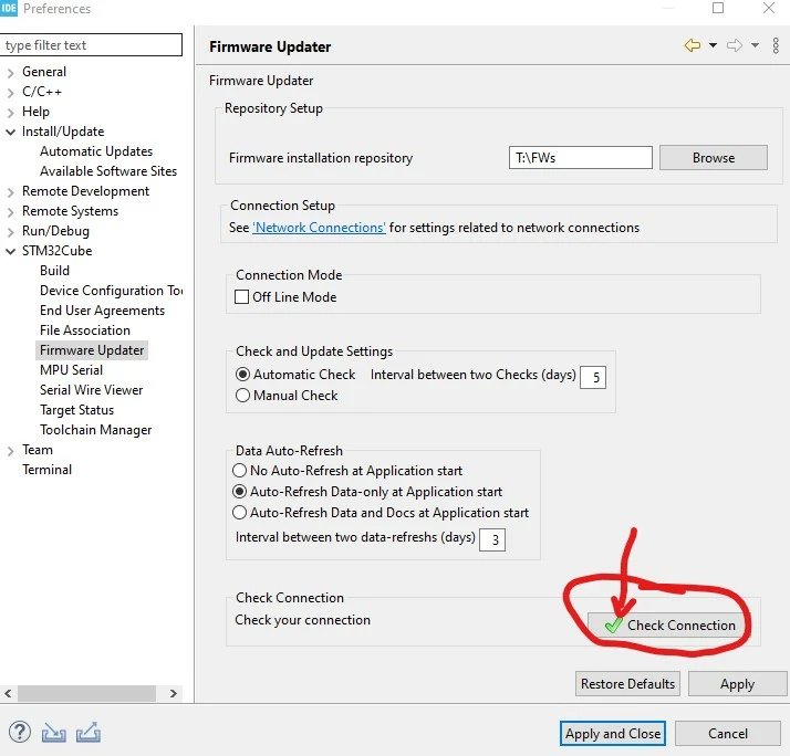

CubeIDE 1.6.0 - Code generation freezes on project done on previous version.
After installation of CubeIDE 1.6.0 Code generation freezes and never unlocks.
Project was done on previous version of CubeIDE with firmware version 1.24.1. When I try to migrate it doesn't change anything. But if I use the same IOC for generation of new project it doesn't hangup.

could you share <workspace>/.metadata/.ide.log file and possibly .ioc file ?

Regrading IOC I would need to obfuscate it a little bit. log looks like this:
It looks like it hangs up on access to: http://sw-center.st.com:80

2021-03-26 15:20:44,093 [INFO] RetryExec:97 - I/O exception (org.apache.http.NoHttpResponseException) caught when processing request to {}->http://sw-center.st.com:80: The target server failed to respond
2021-03-26 15:20:44,093 [INFO] RetryExec:113 - Retrying request to {}->http://sw-center.st.com:80

Initiating a new session is Help > Check for Updates able to complete ?
If not fix your remote access. Doing migration process some db download is required. If not able may explain ...

"Help > Check for Updates" is working correctly.

Are you able to get following green check ?

Yes

now log during generation hangs in different place:

It looks, that with the newest update (Version: 1.6.1 Build: 9958_20210326_1446 (UTC)) of CubeIDE problem disappeared.

Thanks for sharing. Thinking on my side local issue. Updating your IDE has just helped to perform some local state refresh.
Hopefully working now for you !
