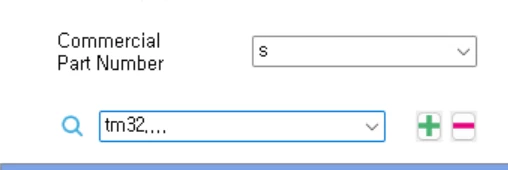

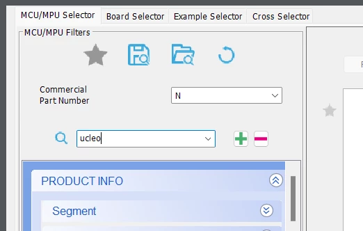

CubeIde 1.15.1 moves cursor when tying part number for new project
when creating a new project, and I start typing in the "Commercial Part Number" field, the cursors moves to another field after the first character.
Here I was trying to type "Nucleo" and the cursor moved to the other filed after the first keypress.

    I didn't reproduce the behavior with 1.15.1:
    When I type N the text is kept in the field and list of available devices occurs.
    Could it be something related to your keyboard? did you try the same on another PC?

    I've experienced the same problem.
    I'm using windows 11,
    cube ide Version: 1.15.1, which is upgraded from 1.12.1.
    Build: 21094_20240412_1041 (UTC).

    @Sarra.S another user is facing the same behavior. Unfortunately I can’t reproduce it.

    Hello everyone,
    This issue is fixed in STM32CubeIDE 1.16.0 release which published on ST.com.
