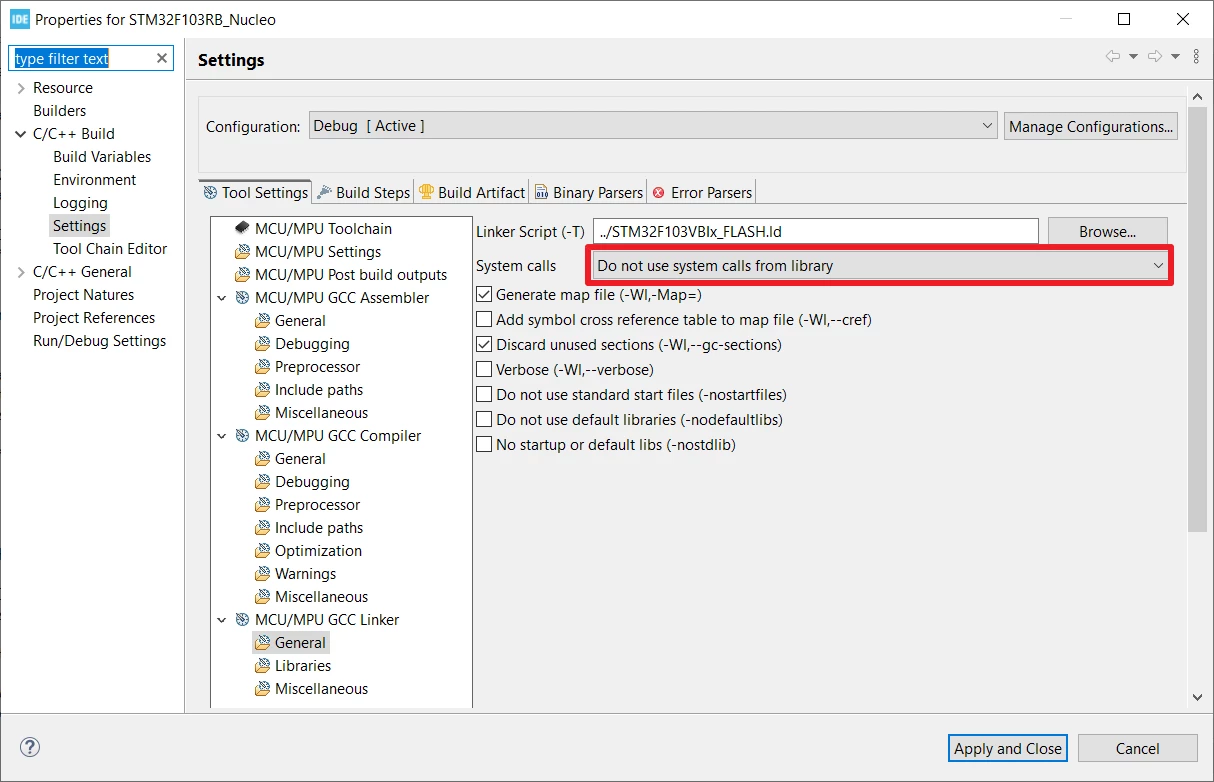

我使用STM32F103RBT6的NUCLE板,使用CUBEIDE编译过程中警告如下:
电邮:/STM32CubeIDE_1.17.0/STM32CubeIDE/plugins/com.st.stm32cube.ide.mcu.externaltools.gnu-tools-for-stm32.12.3.rel1.win32_1.1.0.202410251130/tools/bin/../lib/gcc/arm-none-eabi/12.3.1/../../../../arm-none-eabi/bin/ld.exe:E:/STM32CubeIDE_1.17.0/STM32CubeIDE/plugins/com.st.stm32cube.ide.mcu.externaltools.gnu-tools-for-stm32.12.3.rel1.win32_1.1.0.202410251130/tools/bin/../lib/gcc/arm-none-eabi/12.3.1/../../../../arm-none-eabi/lib/thumb/v7-m/nofp\libc_nano.a(libc_a-closer.o):在函数 '_close_r' 中:
(.text._close_r+0xc):警告:_close 未实现,并且总是失败
E:/STM32CubeIDE_1.17.0/STM32CubeIDE/plugins/com.st.stm32cube.ide.mcu.externaltools.gnu-tools-for-stm32.12.3.rel1.win32_1.1.0.202410251130/tools/bin/../lib/gcc/arm-none-eabi/12.3.1/../../../../arm-none-eabi/bin/ld.exe:E:/STM32CubeIDE_1.17.0/STM32CubeIDE/plugins/com.st.stm32cube.ide.mcu.externaltools.gnu-tools-for-stm32.12.3.rel1.win32_1.1.0.202410251130/tools/bin/../lib/gcc/arm-none-eabi/12.3.1/../../../../arm-none-eabi/lib/thumb/v7-m/nofp\libc_nano.a(libc_a-lseekr.o):在函数 _lseek_r 中:
(.text._lseek_r+0x10):警告:_lseek 未实现,并且总是失败
E:/STM32CubeIDE_1.17.0/STM32CubeIDE/plugins/com.st.stm32cube.ide.mcu.externaltools.gnu-tools-for-stm32.12.3.rel1.win32_1.1.0.202410251130/tools/bin/../lib/gcc/arm-none-eabi/12.3.1/../../../../arm-none-eabi/bin/ld.exe:E:/STM32CubeIDE_1.17.0/STM32CubeIDE/plugins/com.st.stm32cube.ide.mcu.externaltools.gnu-tools-for-stm32.12.3.rel1.win32_1.1.0.202410251130/tools/bin/../lib/gcc/arm-none-eabi/12.3.1/../../../../arm-none-eabi/lib/thumb/v7-m/nofp\libc_nano.a(libc_a-readr.o):在函数 _read_r 中:
(.text._read_r+0x10):警告:_read 未实现,并且总是失败
E:/STM32CubeIDE_1.17.0/STM32CubeIDE/plugins/com.st.stm32cube.ide.mcu.externaltools.gnu-tools-for-stm32.12.3.rel1.win32_1.1.0.202410251130/tools/bin/../lib/gcc/arm-none-eabi/12.3.1/../../../../arm-none-eabi/bin/ld.exe:E:/STM32CubeIDE_1.17.0/STM32CubeIDE/plugins/com.st.stm32cube.ide.mcu.externaltools.gnu-tools-for-stm32.12.3.rel1.win32_1.1.0.202410251130/tools/bin/../lib/gcc/arm-none-eabi/12.3.1/../../../../arm-none-eabi/lib/thumb/v7-m/nofp\libc_nano.a(libc_a-writer.o):在函数 '_write_r' 中:
(.text._write_r+0x10):警告:_write 未实现,并且总是失败
E:/STM32CubeIDE_1.17.0/STM32CubeIDE/plugins/com.st.stm32cube.ide.mcu.externaltools.gnu-tools-for-stm32.12.3.rel1.win32_1.1.0.202410251130/tools/bin/../lib/gcc/arm-none-eabi/12.3.1/../../../../arm-none-eabi/bin/ld.exe:警告:找不到入口符号Reset_Handler;默认为 08000000
已完成的构建目标:batt12.elf
arm-none-eabi-size batt12.elf
arm-none-eabi-objdump -h -S batt12.elf > “batt12.list”
文本数据 bss dec hex filename
96 0 1568 1664 680 batt12.elf
构建完成:default.size.stdout
已完成的构建:batt12.list
22:55:36 构建完成。0 个错误,5 个警告。(耗时 6 秒 387 毫秒)
好像需要使用完成的C库来进行编译。实现应该如何来实现?

Ethan HUANG
February 7, 2025
關於底下四個warning:
  • (.text._close_r+0xc):警告:_close 未实现,并且总是失败
  • (.text._lseek_r+0x10):警告:_lseek 未实现,并且总是失败
  • (.text._read_r+0x10):警告:_read 未实现,并且总是失败
  • (.text._write_r+0x10):警告:_write 未实现,并且总是失败
可以試著在如下圖所示的linker設定當中將System calls改為 "Do not use system calls from library"將四個warning解除:
關於「警告:找不到入口符号Reset_Handler;默认为 08000000」,請確定在CubeIDE project當中有類似如下的檔案:
https://github.com/STMicroelectronics/STM32CubeF1/blob/master/Projects/STM32F103RB-Nucleo/Examples/GPIO/GPIO_IOToggle/SW4STM32/startup_stm32f103xb.s
February 8, 2025

根据提示作所有的警告变成了错误,方法好像不对呀。
