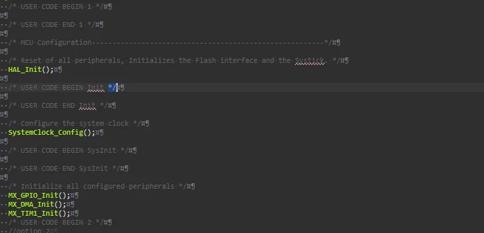

why the ide show these type of values how to hide it ?

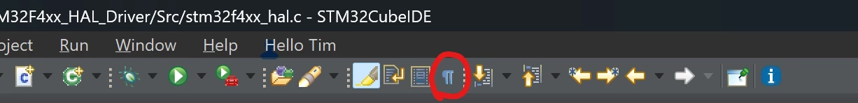

The icon that @Radosław showed is a toggle button in the toolbar. Click it to toggle whitespace.

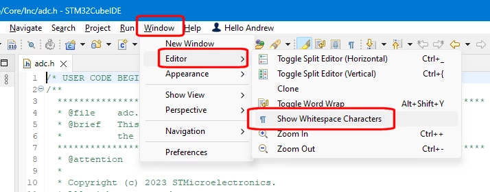

@thannara123 and if you can't see it on a toolbar, it's under the 'Window' menu:
As the name suggests, it's showing you all the whitespace characters - CR, LF, Space, and TAB.
Note that this is a standard Eclipse feature - not specific to CubeIDE - and common to most IDEs and Programmer's Editors.
