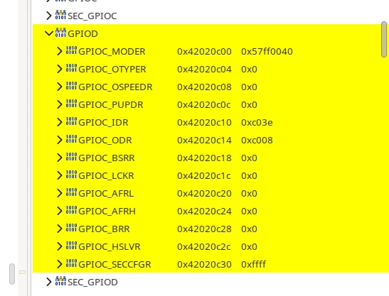

Cube IDE not showing GPIOD, E, F etc, only A, B and C in SFR window
Anyone any idea what is going on here please? GPIOA, B and C show up correctly, but D onwards is showing GPIOC registers!
Proceossor is H563 and I'm running Cube 1.16.0 Build: 21983_20240628_1741 on Linux.

    Hello @DiBosco
    Thank you so much for reporting this issue. I will escalate it to the Concerned team for correction on the coming releases of the SVD file releases (under internal ticket number 188910).
