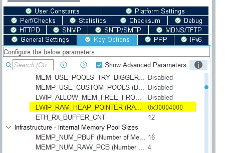

There is a bug in the new cube ide version in the lwip vonfiguration for the STM32F7
LWIP_RAM_HEAP_POINTER (RAM Heap Pointer) 0x30004000
There is no such RAM location in the STM32F7. the correct value should be zero but better u guys check it.

I confirm that there is a mismatch between the  address value in the comment and the actual address.
*----- Default Value for F7/H7 devices: 0x30044000 -----*/
#define LWIP_RAM_HEAP_POINTER 0x30004000
Thank you for your contribution,  The issue was investigated by the STM32cubeMX team (Internal ticket number: 199455 ).

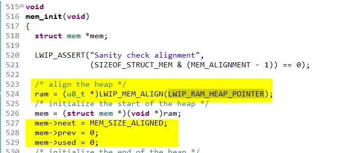

New since 6.13 in `lwipopts.h`:
/*----- Default Value for F7/H7 devices: 0x30044000 -----*/

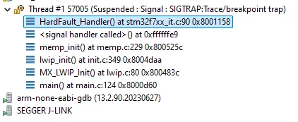

First I don't know why the value in the comment doesn't match with the actual value, second with these two extra lines generated, it breaks my program as in `MX_LWIP_INIT()` would not return. I guess OP isn't wrong.

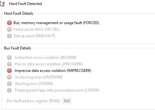

I am encountering the same issue. The STM32CubeIDE 1.16.x project runs ok, but the migration to 1.17.x causes the hard fault exception.
I do not wonder because there has been introduced (in 1.17.x) a new macro
If the .ioc code is generated, this value is added to the lwipopts.h. The ref. manual for STM32F746 is saying that the address 0x30004000 is reserved and probably no heap is there.
I no wonder that the hard fault is generated because of accessing reserved memory
I only migrated project from 1.16 to 1.17, regenerated the code and built.
