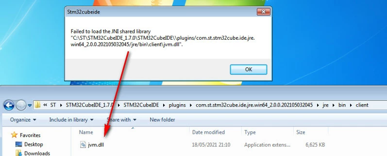

This issue is all over the internet, and as usual with no good solutions.
One of the two files which Cube says is not present actually is in that directory. I am totally stuck, having spent a day on this and downloading all sorts of VC++ redistributable fixes. I am doing this on two machines, both running a win7-64 VMWARE VM. This is Cube 1.7 although I tried 1.6.1 also (which I have running ok on the base machine, but that machine has had years of updates...

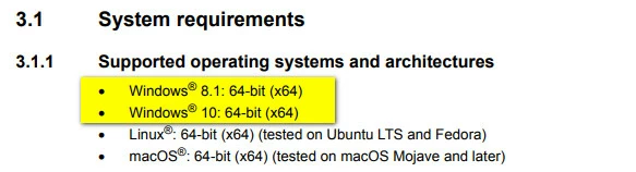

Edit: just discovered the likely cause of the problem: ST changed their system requirements post v1.4:
 although for some reason the online update to 1.6.1 worked ok on two win7-64 machines. But doesn't work on a 3rd win7-64 Enterprise SP1 running in a VMWARE VM.

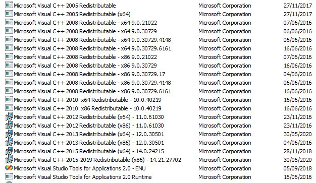

It appears to be a dependency on which version of VC++ redists you have installed. Cube seems to need at least VC++ 2015, but this is extremely difficult to "just install"; you get obscure 8 digit hex error codes which google to huge numbers of ineffective solutions. The way to get VC++, up to 2019, was via regular M$ Windows updates, but they stopped a while ago.

"VC 2017 should work on Win7."
It does (this is from my win7-64 PC). You just can't install it from any of the install packs. It used to come on the M$ auto updates but they stopped (except for paying M$ support customers)
and sure enough Cube 1.6.1 runs fine on this PC. I just don't dare try to update to 1.7 in case it is broken on win7, and then I could get stuck.
