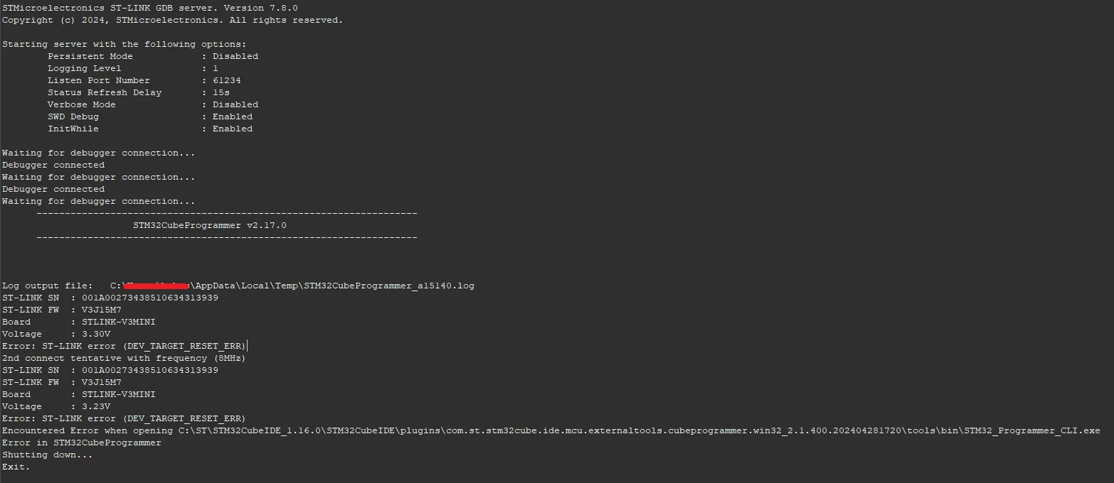

This sort of thing is a way of life with these ST tools (been using Cube IDE for 6 years on this project) but this one I am unable to fix. Is there some special setting needed under Debug (under project/properties)?
STMicroelectronics ST-LINK GDB server. Version 7.8.0
Copyright (c) 2024, STMicroelectronics. All rights reserved.
Starting server with the following options:
Persistent Mode : Disabled
Logging Level : 1
Listen Port Number : 61234
Status Refresh Delay : 15s
Verbose Mode : Disabled
SWD Debug : Enabled
ST-LINK device status: UNKNOWN
Waiting for debugger connection...
Debugger connected
Debugger connected
Encountered Error when opening C:\ST\STM32CubeIDE_1.16.0\STM32CubeIDE\plugins\com.st.stm32cube.ide.mcu.externaltools.cubeprogrammer.win32_2.1.400.202404281720\tools\bin\STM32_Programmer_CLI.exe
Error in STM32CubeProgrammer
Shutting down...
Exit.
I've tried 2 x STLINK ISOL V3 and a STLINK ISOL v2. No success.

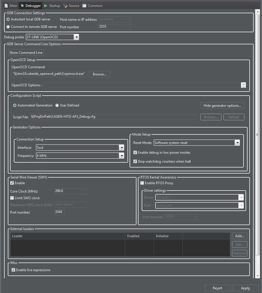

    AScha.3
    August 1, 2024
    Here i am on IDE V 1.14.1 .  (working fine - so why i should risk any "update" to unknown state ?? :) )
    + blocking all online/update search etc. -> offline mode seems helping a to keep stable workset .
    (If v 16... dont work, just use older Version and see next update for V16.. , maybe then ok again)
    ST-links i use : V3-miniE , V3-mods , V2  (the "clones" , but all with STM chips..) ;
    and also GDB and OCD ...sometimes one not working, so i choose the other. ...and back.

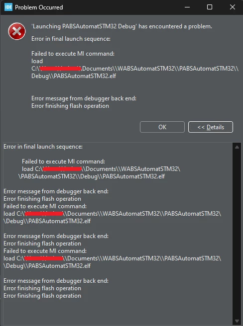

    I have the same problem. I use STM32 CUBE IDE V1.16 and ST-LINK/V2. I could not solve the problem.
    August 19, 2024
    I have the same problem with both the V1.14 and V1.16 versions.
    I use the STLINK-V3MINI and my OS is Windows 11.
    I should point out that everything was working 4 months ago.....
    I couldn't solve the problem !
    MESSAGE:
    STM32 CubeIDE:
    I really need a solution to move my project forward!

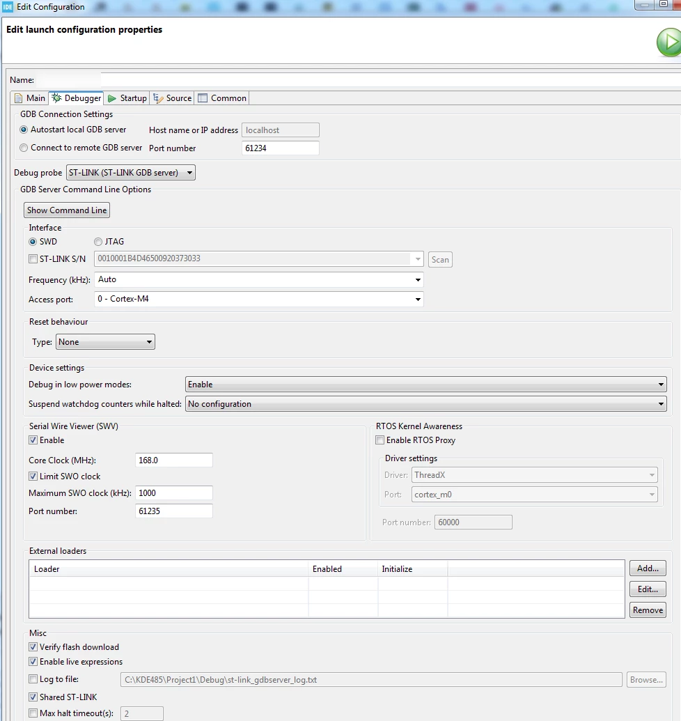

    AScha.3
    August 19, 2024

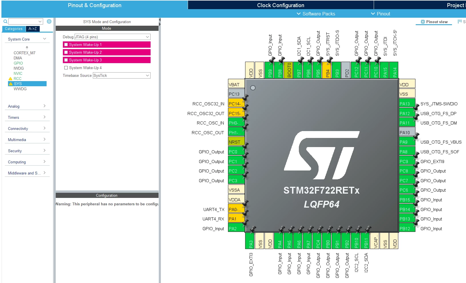

    What you set for connecting mode?
    Try: hardware reset, + under reset.
    That's helpful, if you did anything to set the chip to a mode, that not allows normal access, maybe not set debug in Cube or using a debug pin for any other way, as I/o pin or so.

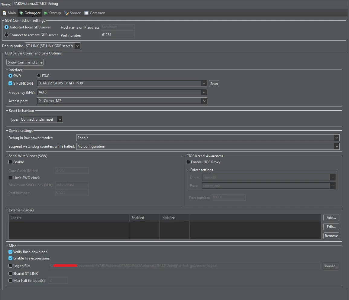

    August 20, 2024
    Hi @AScha.3 , thank you for your reply.
    I'm not sure I understand your question.
    My hardware connection mode is configured like this:
    Then I use a basic USB cable.
    This setup has always worked correctly.
    The BOOT0 pin is connected to GND.
    My DEBUG configuration is done like this:
    I also updated the STLINK-V3MINI and did a ‘clean’ of the project.
    I also want to say that I managed to flash the MCU the very first time with my programme, but then it wasn't possible any more.

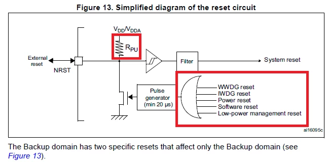

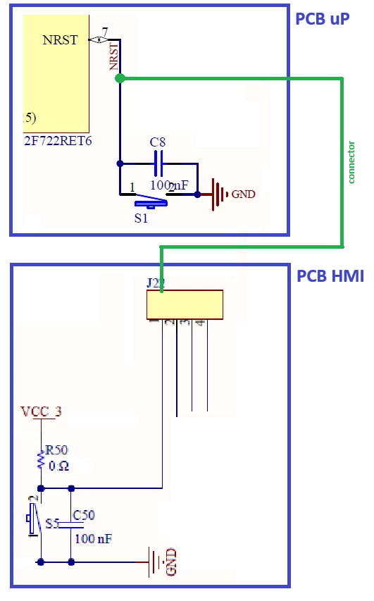

    My hardware consists of several PCBs linked via connectors. On 2 of them there is a button that allows the uP to be reset. The aim is for the reset to be as accessible on the PCB containing the uP as it is on the one for the HMI.
    In the end, the uP reset is connected as follows:
    When I press S5, the 0 ohm resistor R50 causes a short circuit on NRST.
    According to the ST documentation, the pull-up resistor (Rpu, framed in red) for the NRST input is internal and fixed, so there is no need to add one.
    I didn't understand why it didn't work because when I used STMCubeProgrammer I could load the program without any problem.
    My intuition is that when using STMCubeIDE, at the time of debugging, the uP activates one of these outputs (framed in red) and pulls the transistor to ground. This causes the internal reset but it also causes the short-circuit due to my 0 ohm resistor R50. Conversely, when loading the program with STMCubeProgrammer, the uP does not activate the outputs because it uses the NJRST and this does not cause a short-circuit.
    I simply removed R50 and C50 and that solved the problem.
    I hope my answer is clear enough.
    BarryWhit
    Lead
    September 8, 2024
    @Boris19, not just that but (based on your schematic) every time you press S5 you're shorting the output of your power supply to ground. That's... novel.

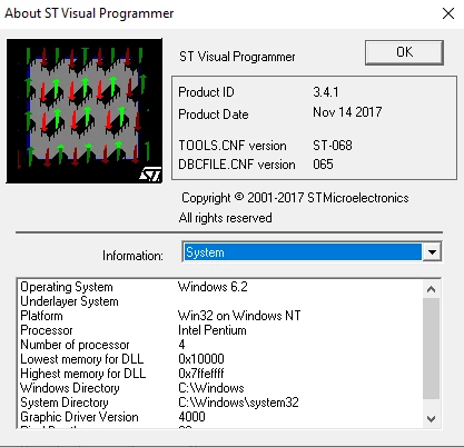

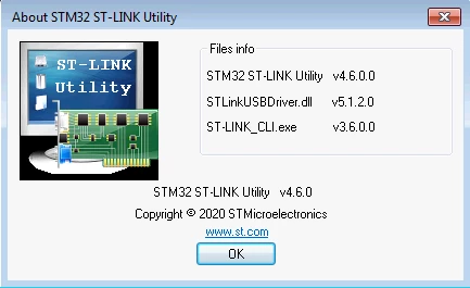

    I do also drive it from the old utilities e.g.
    STM ST LINK UTILITY
    ST VISUAL PROGRAMMER
    These are both old but there is AFAIK no current replacement. And when Cube IDE doesn't find the debugger, these sometimes find it and sometimes not.
    Both STLink utility and STVP have been deprecated in favor of STM32CubeProgrammer, for several years.

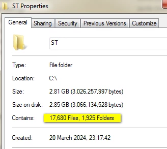

    September 8, 2024
    The usual :)
    It is a separate download, not a part of Cube IDE.
    I uninstalled it and fortunately Cube IDE still works. This mega bloated java stuff tends to be tricky as to dependencies but ST's stuff tends to be self contained so no idea what this is.
