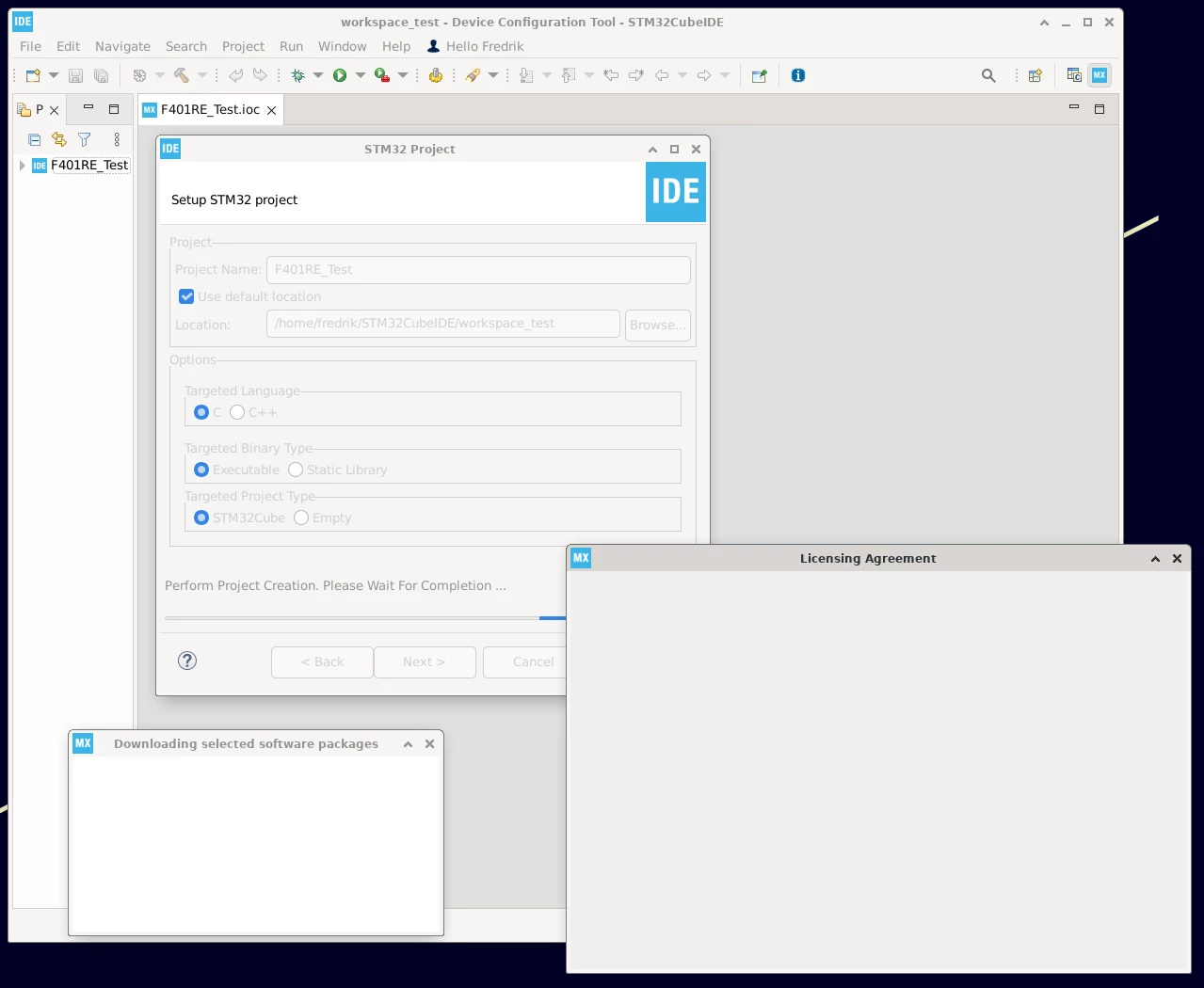

Cube IDE 1.15.1 Freeze when creating example project
Hi, I am trying to create an example project for my NUCLEO-F401RE board by following the following steps:
1. Completely clean Debian 11.9.0 installation (in virtual machine)
2. Download and install STM32CubeIDE 1.15.1 (STM32CubeIDE-DEB)
3. Launch the IDE and create a C-project for the board. All path and pin settings default.
4. During the project setup process a "Licensing Agreement" window pops up and the IDE freeze (see attached screenshot).
Do you have any suggestion what is going wrong?
thanks

Hi, I tried your suggestion and used the generic Linux installer instead of the dedicated Debian, and this works much better!
I created a completely clean VM and installed Debian 11.9.0 (Debian 12 is not shipped with the Python version required by STM32CubeIDE). After installing some missing .so files
    sudo apt-get install libncurses5
I am able to compile and debug project without problem.

I suspect something is not correct in the installation script. When launching stm32cubeide using "sudo" I manage to create project and run without problem.
cd /opt/st/stm32cubeide_1.15.1
sudo /opt/st/stm32cubeide_1.15.1/stm32cubeide_wayland %F
But using this method I run into other problems. For example is the web-browser required to view some documents not be launched as root.

i have IDE 1.13.1 running on my old Mx18 Linux ...
but i used not deb , but the "generic" version ( Mx is debian based, but deb version not working..).
And on update/new install i had to modify the rights on the top directory (/opt/st -> + all subs ) to allow full user access.
Maybe you should try this .

After some more digging I found the problem was related to the java settings.
I used the suggestion on this page: https://stackoverflow.com/questions/23960451/java-system-preferences-under-different-users-in-linux
After creating the .java folders and setting the required permissions I am able to start the IDE using the following command:
export JAVA_OPTS="-Djava.util.prefs.systemRoot=/home/user/.java -Djava.util.prefs.userRoot=/home/user/.java/.userPrefs"
I still get some warning messages in the log, but the IDE seems to work anyway also when not root.
