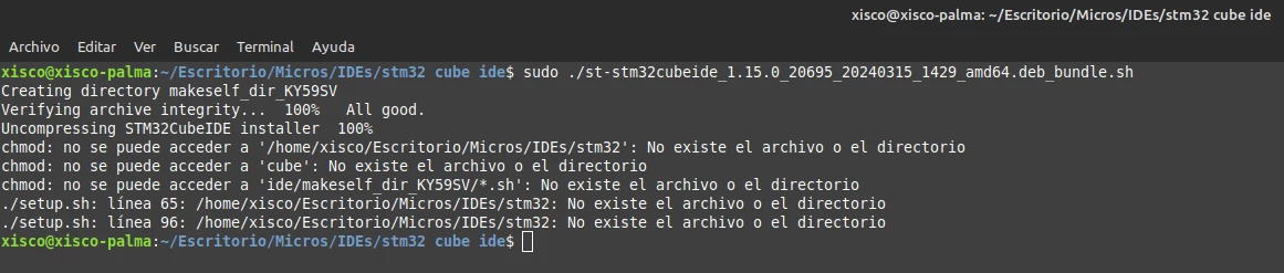

Cube IDE 1.15.0 installation fails when folder name contains spaces (Linux)
When the folder name of installer contains spaces, the installer tries to do a chmod to all words of the folder name.
Solved renaming the folder.

Hello @xisco and welcome to the community,
This behaviour is expected as the installation folder should not contain any spaces.
Thanks,
Rim.

@Rim LANDOLSI Then could the CubeIDE installer warn about bad install path?
Rim LANDOLSI
March 27, 2024
Hello @Pavel A. ,
This suggestion is not integrated in the CubeIDE installer. So, a change request ticket 177163 has been submitted to the development team for further investigation to add a warning to the CubeIDE installer about bad installation paths.
