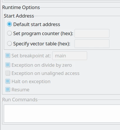

Create Run and not Debug configuration
How can I configure a Run configuration for flashing that doesn't also break and throw me into the debugger?
0693W00000DlXCaQAN.pngNote how all the relevant options in my Run configuration are greyed out. How can I enable them?

I accidentally found it. If you view the configurations via Run Configurations ... then the area above is greyed out. If you view configurations via Debug Configurations ..., then they are editable.
Way to go, STM32CubeIDE.

IRC the "default start address" in this context means that debugger resets the target and then lets it run freely, as it normally would after a reset.
Do you want a different behavior?

Thanks Pavel, but I'm talking about the greyed-out area below that. In particular, I want to disable the "Set breakpoint at" option.

Those options are grayed out because in a Run configuration, the debugger is not connected. If they're not grayed out, it's a Debug configuration.

Yes, I found out. It's just weird, since the page I arrive at is the same in both cases. Also, no matter which way I choose, I see both Run and Debug configs, making the current implementation not really intuitive.
August 30, 2021
Why is it weird that Debug-only options are grayed out in Run configurations?
