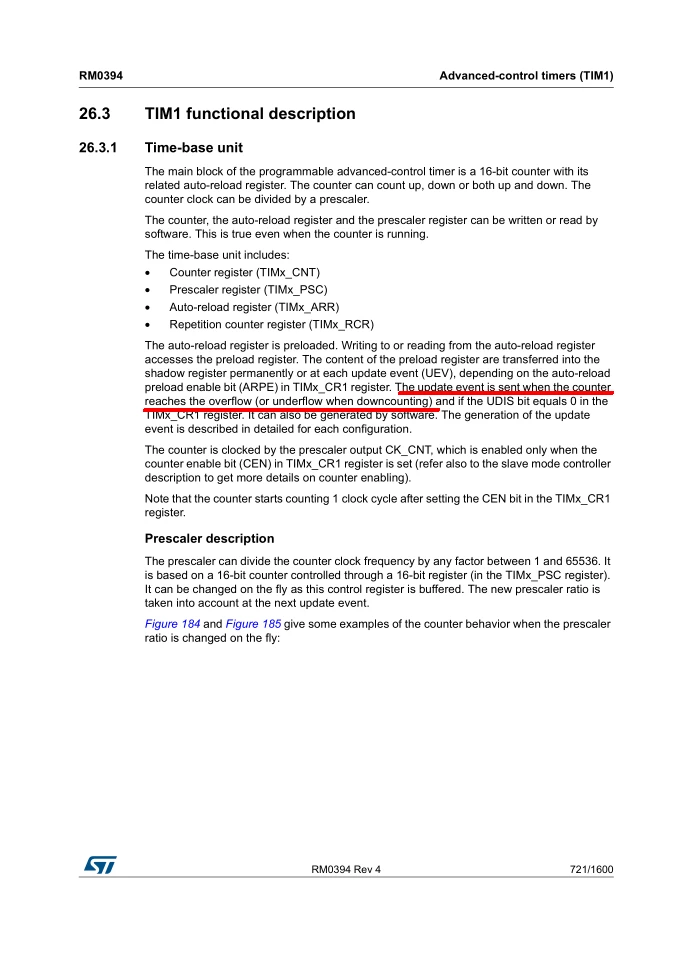

For the timers on stm32I412kb I did not find any overrun- and/or underrun-flags, nor interrupt-flags for this purpose.
waclawek.jan
August 4, 2022
In STM32 timers, what you'd refer to as under/overrun, is called Update.

I use stm32l412kb because I have an eval board with it, but I want to unse stm32f030 in my final design.
Quote from page 780 of RM0394:
" Bit1 UDIS: Update disable
This bit is set and cleared by software to enable/disable UEV event generation.
0: UEV enabled. The Update (UEV) event is generated by one of the following events:
  • – Counter overflow/underflow
  • – Setting the UG bit
  • – Update generation through the slave mode controller
Buffered registers are then loaded with their preload values.
1: UEV disabled. The Update event is not generated, shadow registers keep their value
(ARR, PSC, CCRx). However the counter and the prescaler are reinitialized if the UG bit is set or if a hardware reset is received from the slave mode controller.
