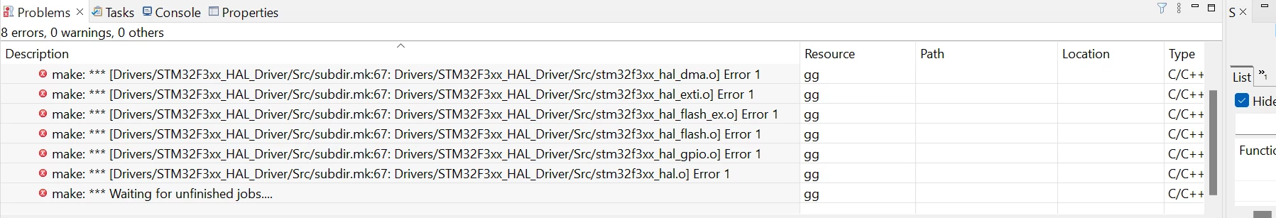

Could somebody help me with this strange hal.o thing?

    Don't you have more detailed output, like from the console?
    Looks more llike an error in the toolset/setup, not in your code.
    Can you build a new project using the generated skeleton code only?
    hth

    SweedAuthor
    January 10, 2024
    Its like this

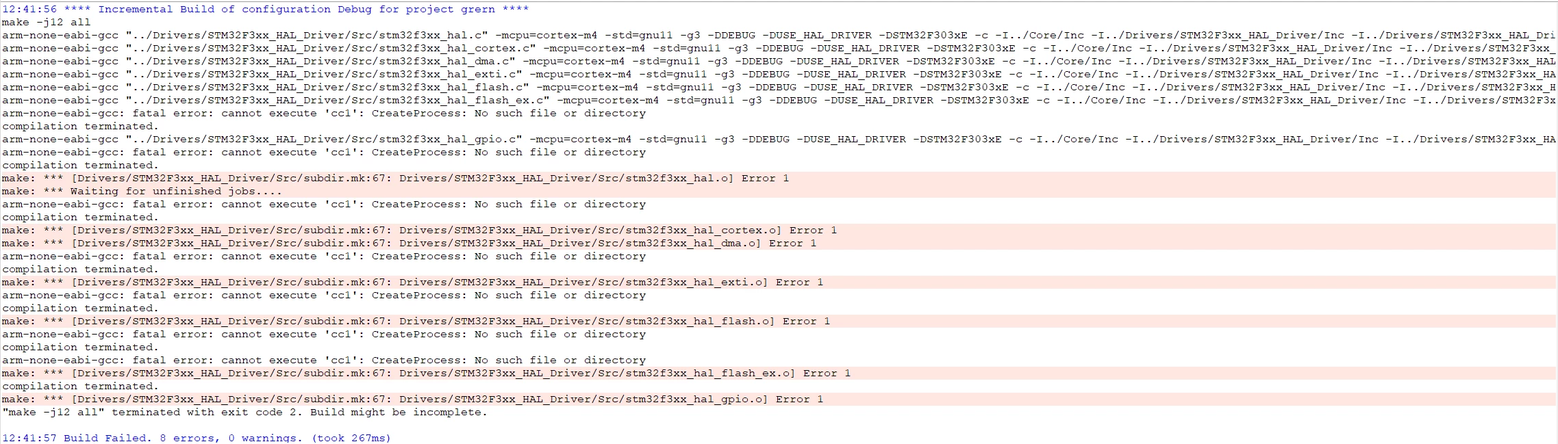

    i also attach build log file

    Oh. And it doesnt compile as a default project. Even when I just add 4 PWM channels, generace C code and press run this error occurs.

    Complaining it can't find or load CC1, a pass of the compiler. Check presence of tool files and PATH setting. Not installed properly. Do as Admin.

    in addition, make sure that
    - the IDE is installed on a short, simple path like C:\ST\ not containing white space, umlauts, and other "difficult" chars that the underlying software cannot properly handle
    - there are no competing other compiler toolchains on the path.
    hth

    Hello @Sweed and welcome to the community,
    Could you check the include paths of the project and make sure that the path "../Drivers/STM32F3xx_HAL_Driver/Inc" is included. If it is not the case, it may be causing the problem you have found.
