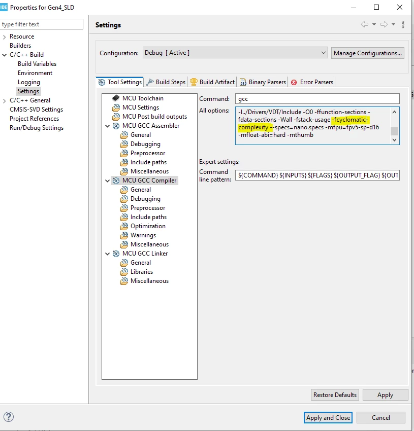

could not edit MCU GCC Compiler
Hello, As I am testing the code, I don't require -fcyclomatic-complexity option that is mentioned in Properties->C/C++ Build->Settings->MCU GCC Compiler->All options.  But I could not edit this column how can I remove this  -fcyclomatic-complexity. I have attached the screenshot of the same below.
Thanks & Regards,
Monika

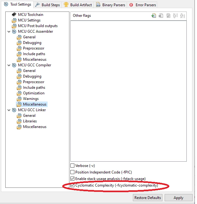

    Hello Monika
    you can disable this functionality here:
    Br. J.T

    Thank you so much for your timely response.
