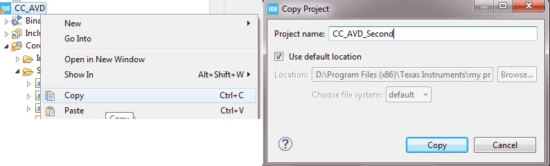

Copy-past project in CubeIDE failed .ioc
I want to clone my cubeIDE 1.6.1 project. But in new project .ioc file contains old name, not "CC_AVD_Second". So I can't use it.
Please add .ioc renaming while project cloning.

April 8, 2021
Clone project may be at risk ... see https://community.st.com/s/question/0D53W00000fnnFwSAI/cubeidewhy-delete-my-src-folder-why-havent-you-fix-it-for-so-long
Sounds project renaming is well supported propagating name update to .ioc file & related content plus .mxproject plus .project & . cproject files.
But project clone or copy ....
