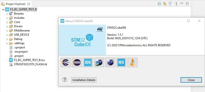

PS: you're right if  FILE>NEW>STM32 Project from an Existing STM32CubeMX Configuration File (.ioc) usage sounds C++ option is ignored :( sounds like a bug ... BUT on my side I'm getting capability to convert to C++ Thanks expected menu

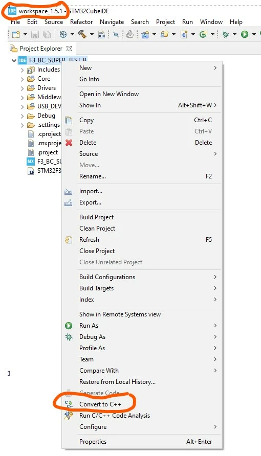

I am right-clicking on the project heading, not the individual file. The Convert option used to be there, so I know where it "SHOULD" be.
How can I upload the project? Can I just zip it and attach it here? Let's see if it works.
Here is my menu. Hope it is readable.

Based on your .zip ... just importing it ... works for me
JGold.2
JGold.2Author
Feb 17, 2021 5:49 PM UTC
I might see it. My workspace reports as 1.3.0 while yours shows 1.5.1 . I think this is just a name.
I'll look into upgrading, or maybe de-installing and re-installing the IDE.
Cartu38 OpenDev
Graduate II
Feb 17, 2021 6:00 PM UTC
Mine. Not able to explain but yes maybe fresh install & fresh workspace may help sounds you've locally something weird ...
