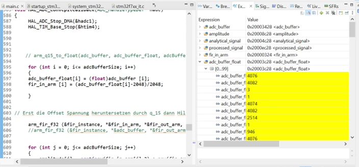

Hello everyone, can someone tell me why casting doesn't work. I want to convert int values of an array to float.
for (int i = 0; i<= adcBufferSize; i++)
adc_buffer_float[i] = (float)adc_buffer [i];

    Show an example data set that's "Not Working"
    SaxAuthor
    January 20, 2024
    Tesla DeLorean
    Guru
    January 20, 2024
    Ok that seems to illustrate the input, it doesn't show the "not working" nor does it show or explain how the output is wrong or incorrect.
    What's the expectation and how does that differ from reality?

    I have the same problem. I read analog values with my ADC and values are type of uint16_t but when i convert my array of values that i get from ADC (Because of doublebuffering) to Float numbers get weird. Is it because of endians, maby overflows i dont know. I have it all on my work PC but i can get a screenshot tomorow.
    I have tried
    for(int n = 0;n < BuffSize;n++){
    FLOATARRAY[n] = (float) INTARRAY[n] * 1.0f;

    You'll need to show the definitions, and datasets which are failing, to have any idea as to why the presented code fragment is failing.
    I doubt it's got anything to do with endian ordering or overflow, as a float should have no trouble representing a number in the 0-65535 range. Where you'll get issues is 8 or more digits.

    I discoverd my problems nest. Its not in typecasting it is in declaration. I have few arrays named
    uint16_t ADC_BUFFER_RAW [ADC_BUFFER_LENGHT];
    float ADC_BUFFER [ADC_BUFFER_LENGHT];
    float FFT_BUFFER [FFT_BUFFER_LENGHT];
    float MAGNITUDE_BUFFER[FFT_BUFFER_LENGHT/2];
    If i define FFT_BUFFER_LENGHT to be more than size of 31,
    it corupts my values found in ADC_BUFFER. I have no idea why.
