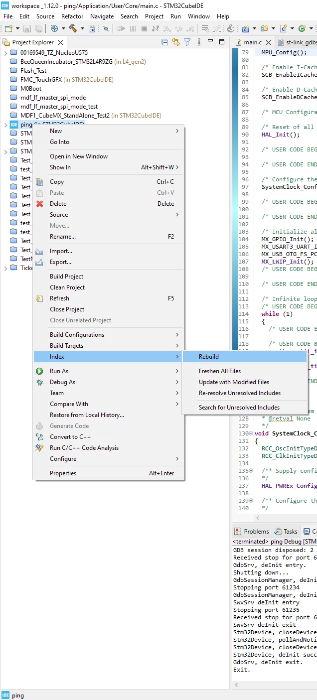

    Hello @Sebovernet
    Try to rebuild the indexer which responsible for the content assist feature.
    To do that right click on any project, go to indexer and click on rebuild as the screenshot shows.
    KR,
    Semer.
